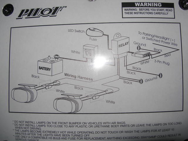

Old Aug 19, 2005 | 09:18 PM
Alexus-Kia's Avatar
Alexus-Kia
Joined: May 2004
Posts: 1,396
From: Connecticut
The member VICESTAN said this will work fine and he has used it! I hope i wont have any problems.

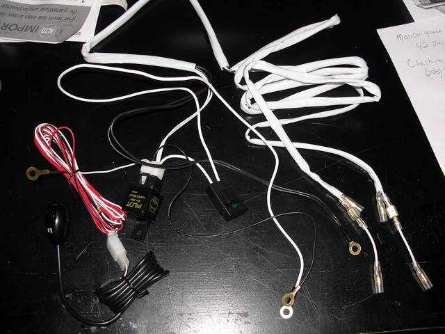

Old Aug 19, 2005 | 09:40 PM
mikal's Avatar
mikal
Joined: Aug 2004
Posts: 2,183
it'll still work but i would have gone with a harness that was made for your application.
If you need help with wiring, unwrap the harness and take a picture of it so we can get a better idea of how that thing is setup to better guide you on your install.
Since you are using that harness, we'll have to chop off some of the OEM plugs.
Old Aug 19, 2005 | 10:40 PM
Alexus-Kia's Avatar
Alexus-Kia
Joined: May 2004
Posts: 1,396
From: Connecticut
Old Aug 19, 2005 | 10:48 PM
trent's Avatar
trent
Joined: Jun 2005
Posts: 705
From: The Round Rock ,TX
Looks simple enough to install, i would probably splice into your existing wires ( parking ,or fog lights lights for example ) so they would come on when you turn those lights on.

Old Aug 19, 2005 | 11:27 PM
mikal's Avatar
mikal
Joined: Aug 2004
Posts: 2,183
I still highly recommend the xenon depot harness. But if you must use this.. here's what you should do.
