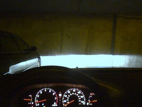

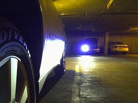

As of tomorrow I may be selling my X5 E39 units and trying another set. They've been nothing short of awesome with good spread and powerful foreground illumination. I'll know for sure as the Hidforum site is down and alot of us sellers and buyers are discombobulated because of the idiot kids that hacked the site. Anyhow, I'm tyring to get in contact with a member there but if I cannot by tomorrow, then I'll put them up for sale.
Here are some pics of them in my ES300 ...
Exact same output as you'll find on X5 trucks or even 745i BMW.
I'll keep you guys posted
