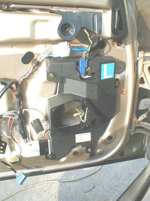

This has been covered previously in other threads, for example:
https://www.clublexus.com/forums/sho...threadid=44187
Here is what you are facing:

Thanks man. Looks a little complicated in there.

Well, I did not show you the pic to scare you off but rather to show you what you'll have to do. Crutchfield probably does not make speaker brackets for that application because you need to do some cutting of the black enclosure. But that is easily cut using a hot soldering iron or Dremel tool- just enlarge that hole you see there enough to allow clearance of the speaker magnet.
