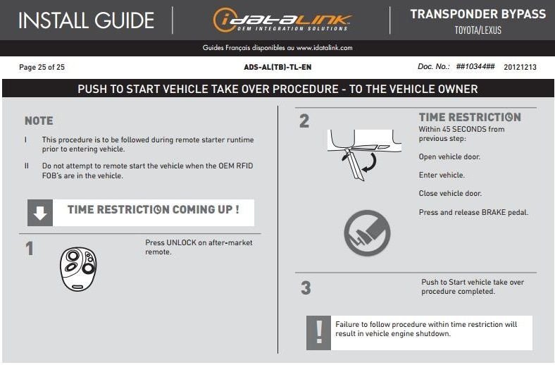

1 - No "secure takeover" function from certain bypass modules (DBALL2 by Directed) on this car, but I found out the (AL-CA by iDatalink) works on 2006-2008 without shutting off the engine. You hit unlock on your aftermarket remote, and then have 45 seconds to enter, hit the brake, and take off.
2 - The installer needs to figure out how to trigger the auto-lights to shut them down. (yes - it IS possible)...
Here are some clues:
iDatalink AL-CA Manual for "takeover". Must run wires into door for unlock from aftermarket alarm/remote start (probably already did).
