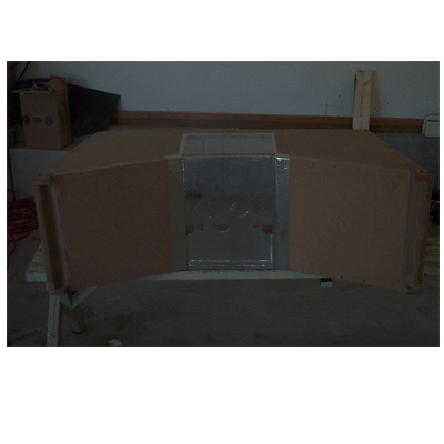

Heres some new pics i added the flames and mirror tape what do you all think for a first sub enclosure?
Heres first pic without flames:

Where did you get the mirror tape? The flames look very nice!
Carpet vs Vinyl.
They are about the same price.
Carpet is FAR more durable than vinyl (A nick in the vinyl and your doomed!!! The white underside will show through).
I personally think vinyl looks better.
Vinyl stretches (depending on the backing you get) but it is very unforgiving. It will show all your defects underneath it. Carpet will cover them. With vinyl, you can add graphics underneath (any type of raised surface) and they will show through. The application is the same (I use 3M Super 77) however, the vinyl will show the "merged" seams very well, the carpet can be brushed so that they don't show.
If this is your first attempt, I'd buy a ton of vinyl and practice, practice, practice. Make sure you have a heat gun (helps to stretch it). If you don't want to put up with the hassle, carpet does look nice, and its very durable and very forgiving.
your supposed to run a thin layer of foam padding underneath the vinyl. If done properly, it will look excellent. if you choose to thicken the foam up any, the sub will appear to countersink into the vinyl.

Sorry, don't mean to step on your toes...
This is true...I'm not sure of the level of experience of the thread originator, but foam backing isn't a cure all. Even with foam, board edges which don't properly meet flush, or screws which aren't counter sunk properly will show (more so than carpet).
