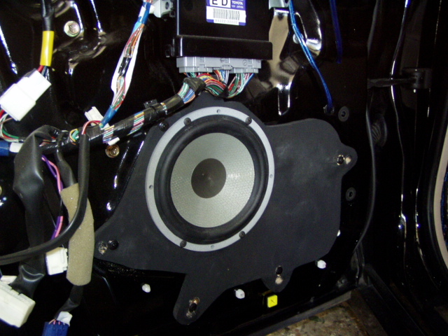

Yes, you're gonna make a new one out of MDF. You will just put the stockers in a box, whole, somewhere. The key is to center it correctly to avoid problems fitting the door panel back or getting in the way of the window coming down. It's not hard. Take into account the depth of the new mid. Mine is a little bigger than some, and it fit just fine.

You can buy MDF at any hardware store like Home Depot. Depending on your skill and equipment, it should not take too long at all. You're welcomed to use the pic as a template. Notice that the reason why it's that shape is that you have to have some clearance around certain equipment/wires already there. Plus you have to factor how to screw it to the door. You'll see it when you get in there, but there are only certain places you can screw into to screw the baffle to the door.

I talked to my installer and I was correct. He did use new places where he screwed the baffle into. This is the reason for the shape of the baffle. It had to be cut that way to allow a place where to screw safely to.
