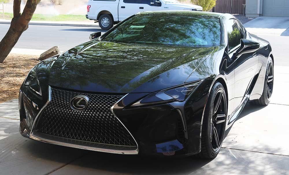

^^^^OK - 255/40/21 and 295/35/21 are the correct after market sizes for third party wheels wide enough to accept them. With that in mind I would not stagger the wheel diameters. I am running the 255/295 combo:
Lou
What rim sizes and manufacturer? They look pretty similar to what I am shaping up to get.

^^^^ From another thread:
Originally Posted by flowrider
I'm running Vossen HF-1 Wheels, 21x9½" front, offset +5 - 21x10½" rear, offset +15.
Tires are Michelin PS4S 255/40/21 and 295/35/21 rear - Non RFT
Lou
