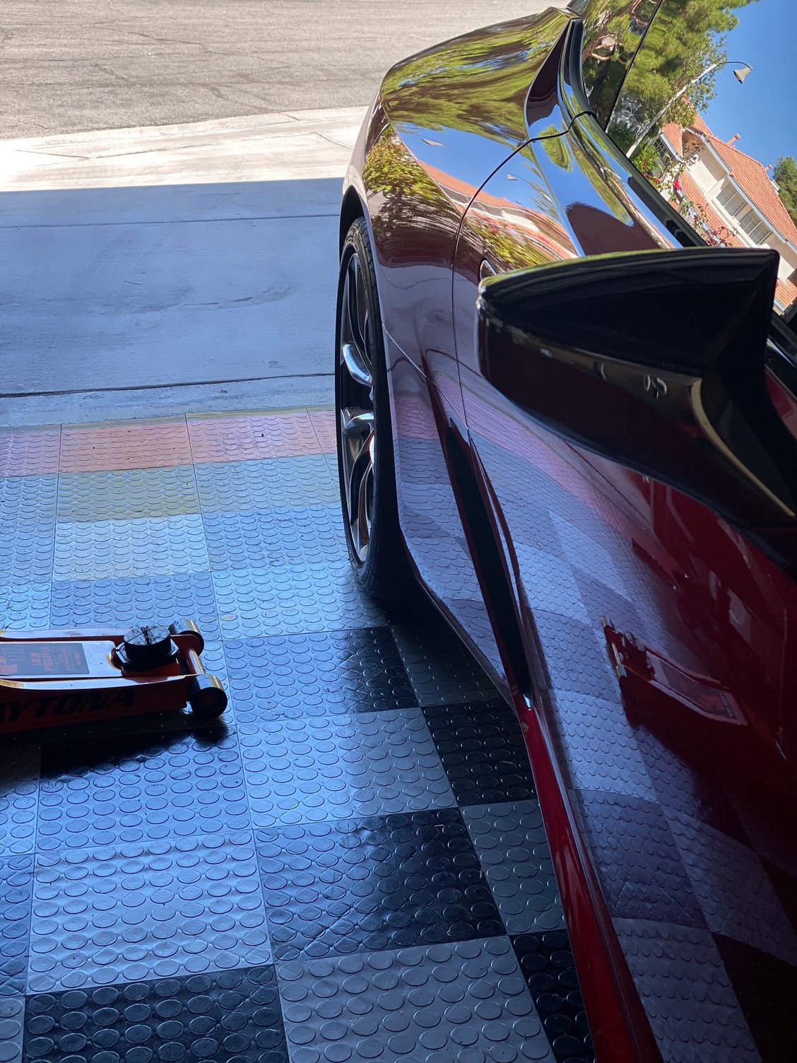

I received the Akata spacers and installed one of them as a test fit. The 20mm offset is perfect and the spacers are beautifully made. I would have no problem running them but since I have custom wheels on the way, I'm just going to sell them for anyone who might want them. Only one of them was installed and removed...not even driven on. $110 shipped....and that's a bargain! I'm glad I ordered them because I can now change the offsets on my forthcoming wheels to match the 20mm offset.

Is this picture with the stock tire size 275, or did you put the 295's on the stock rim?
