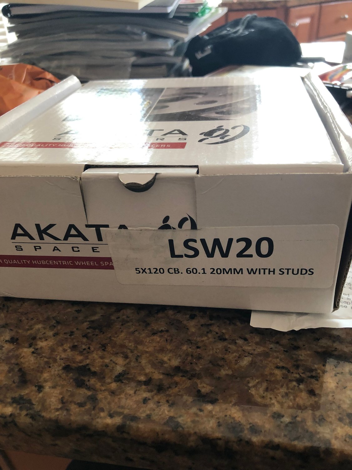

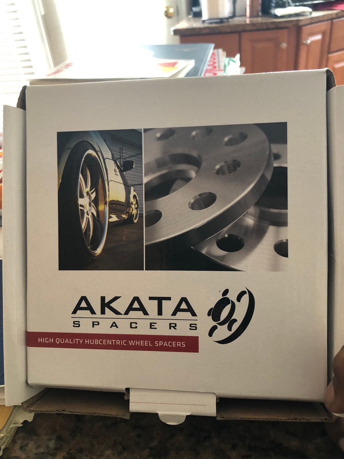

Akataspacer.com, I had to call as the drop down menus didn’t have Lexus in the lineup but they make them for us. Great quality stock ride perfect flush IMO..

So the with the Akata spacers the stock wheels fit back on over the nuts that hold the spacers onto the hubs?

The spacer has its own studs which is a direct fit for our stock wheels. Bolt the spacer onto the stock studs once that’s done bolt the wheel onto the spacer with attached studs. Sounds more complicated than it really is.

I understand the process....just wondering of the recesses in the back of the OEM wheels were deep enough to cover the lugs on the wheel adapters. Might be a stupid question since yours apparently fit just fine.

Not a stupid question at all that’s why we are here to help with the knowledge we have. The recesses on the back fit fine and are more than deep enough, they fit perfect.
