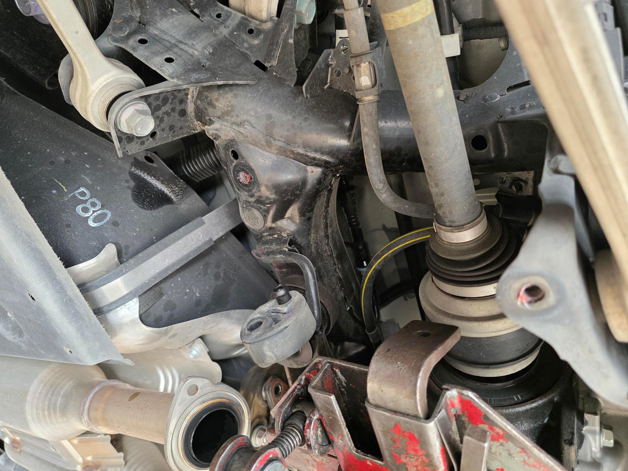

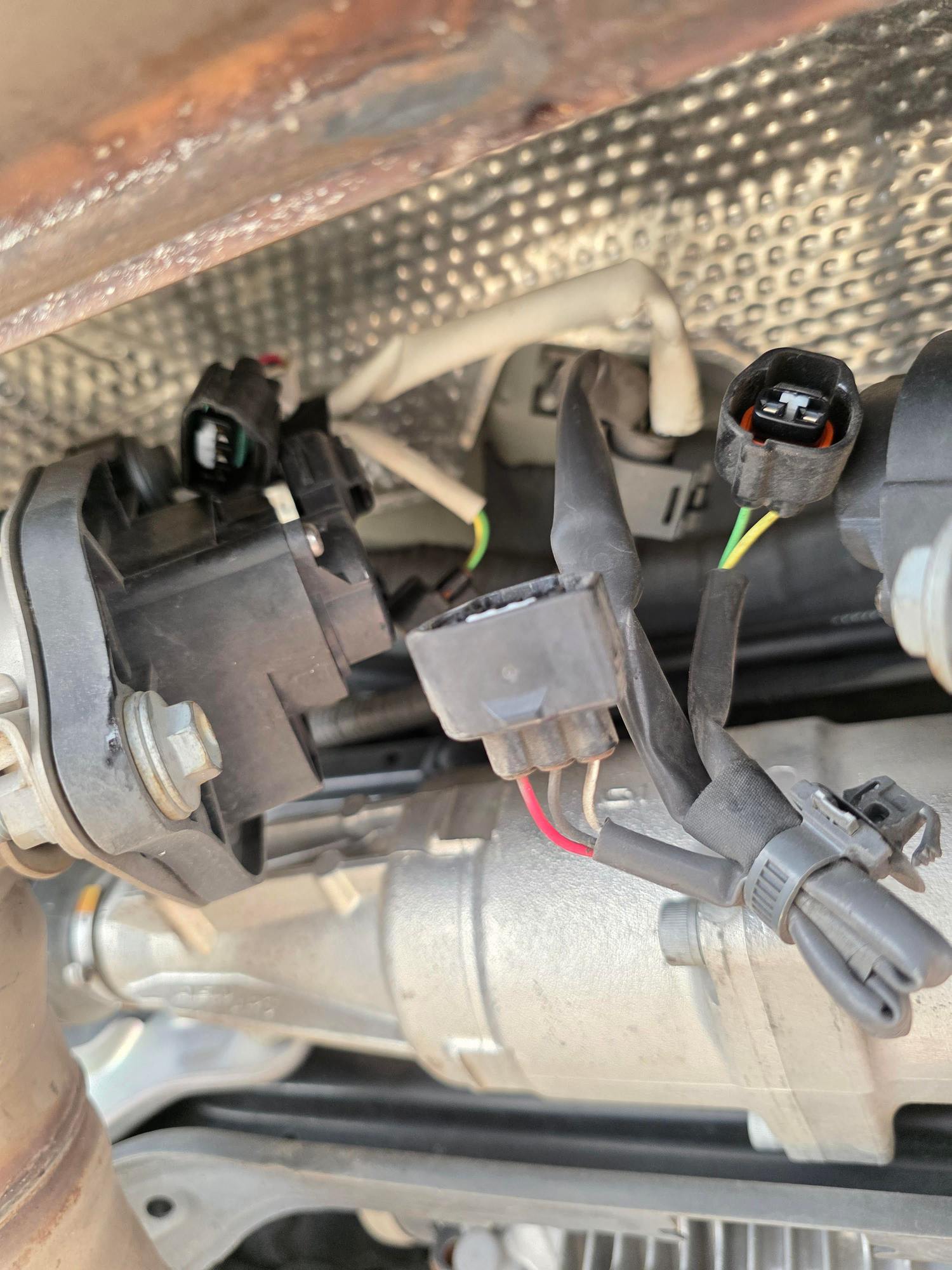

  4. STEP BY STEP INSTALLATION
    1. 1. Starting Removal of Diff
      2. Removal of connectors to exhaust valves  4x

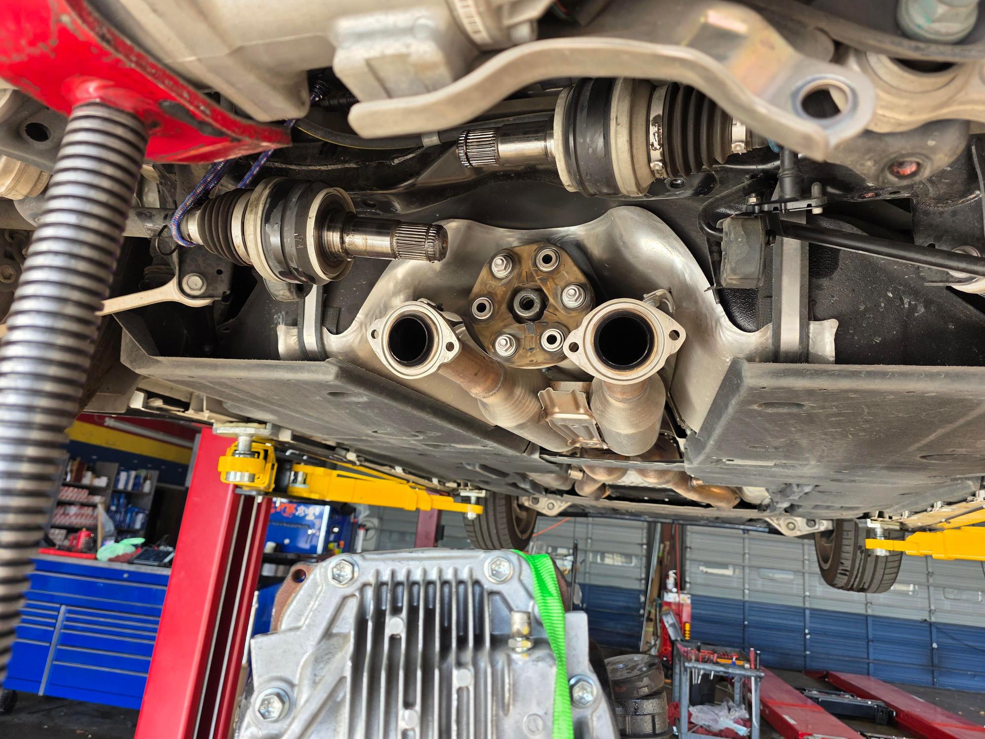

      3. Lowering Exhaust
      3. Lowering Exhaust

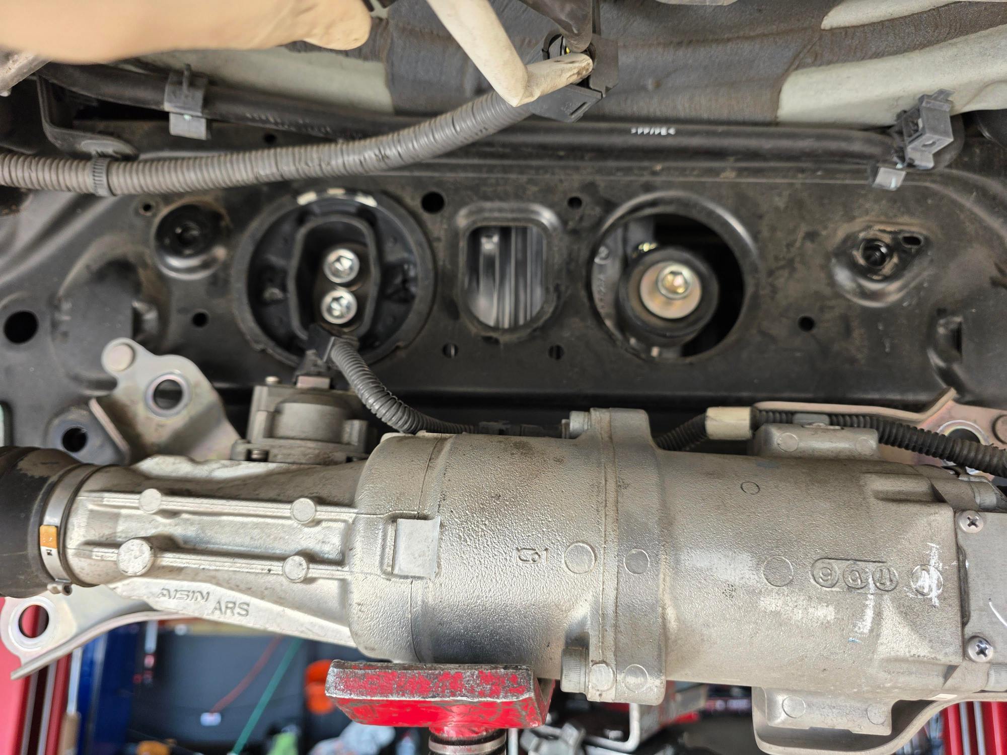

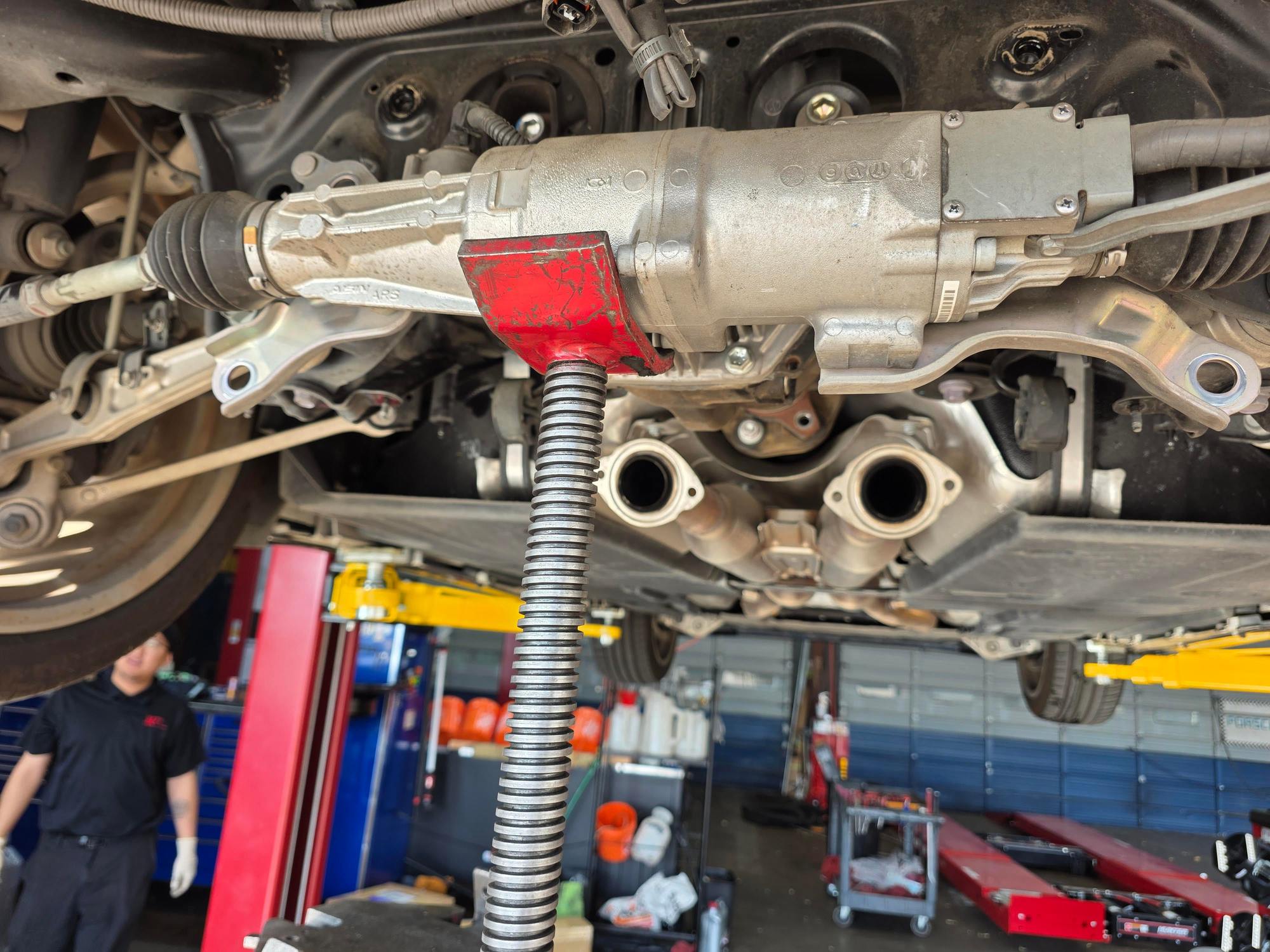

      4. Lowering Steering Rack

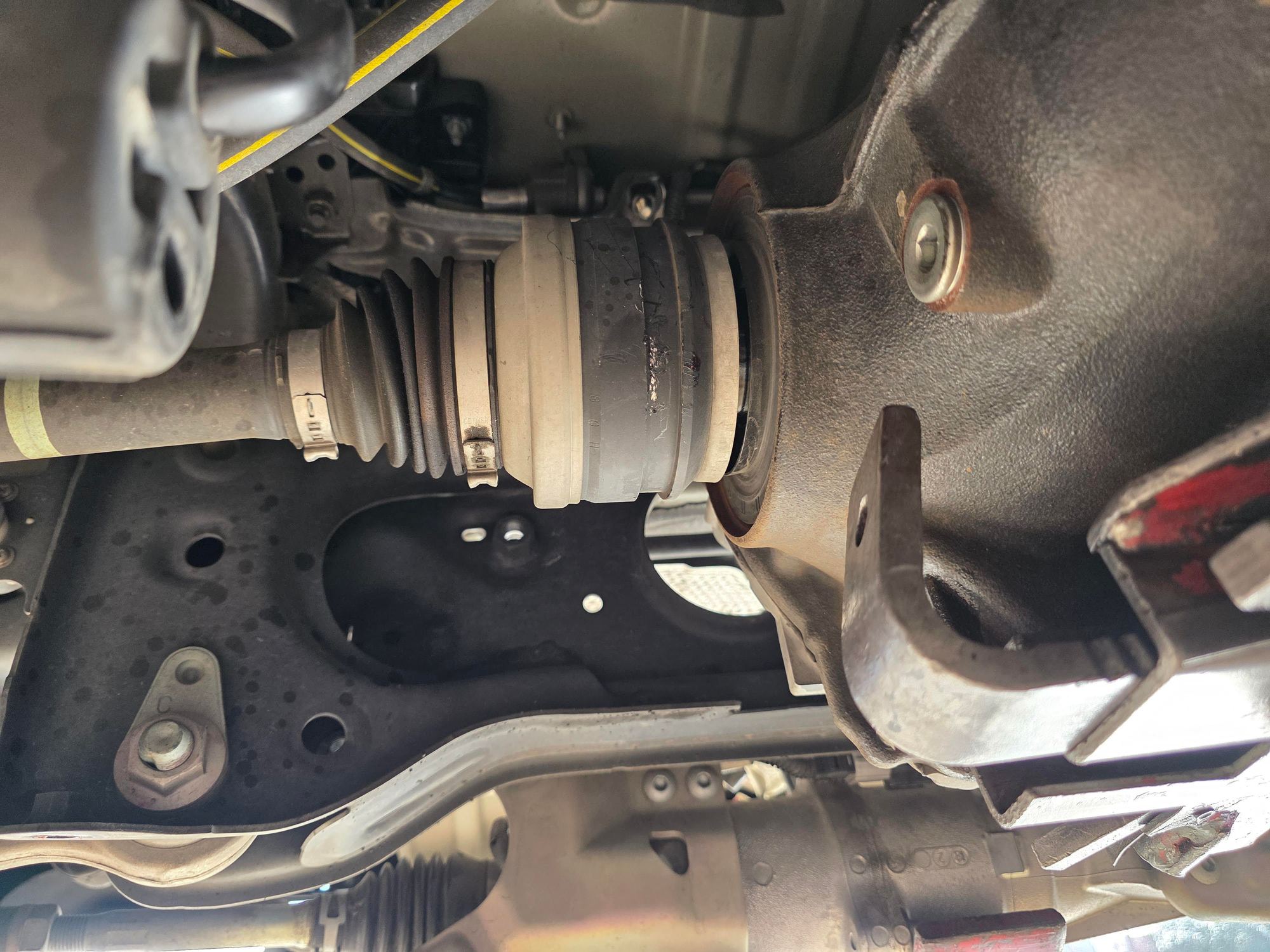

      5. Removal of 4x allern head bolts. Bushing on left side, counterbalance on right side (this counterbalance is going to be replaced by the optional RCF bushing mount included in the parts list. We recommended installing it to reduce differential slop, at the expense of a very slight increase in NVH, likely imperceptible.)
      6. Removal of rear brackets to allow differential to come down
      7. Before removing the forward 19mm differential mounts, I slightly removed axles on both sides, this kept the differential stable during axle removal
      8. Here you can see the differential being dropped down. Also you can see the 3 nuts and bolts to the driveshaft that are removed. I also suspended the axles upward to avoid stress on the boots.

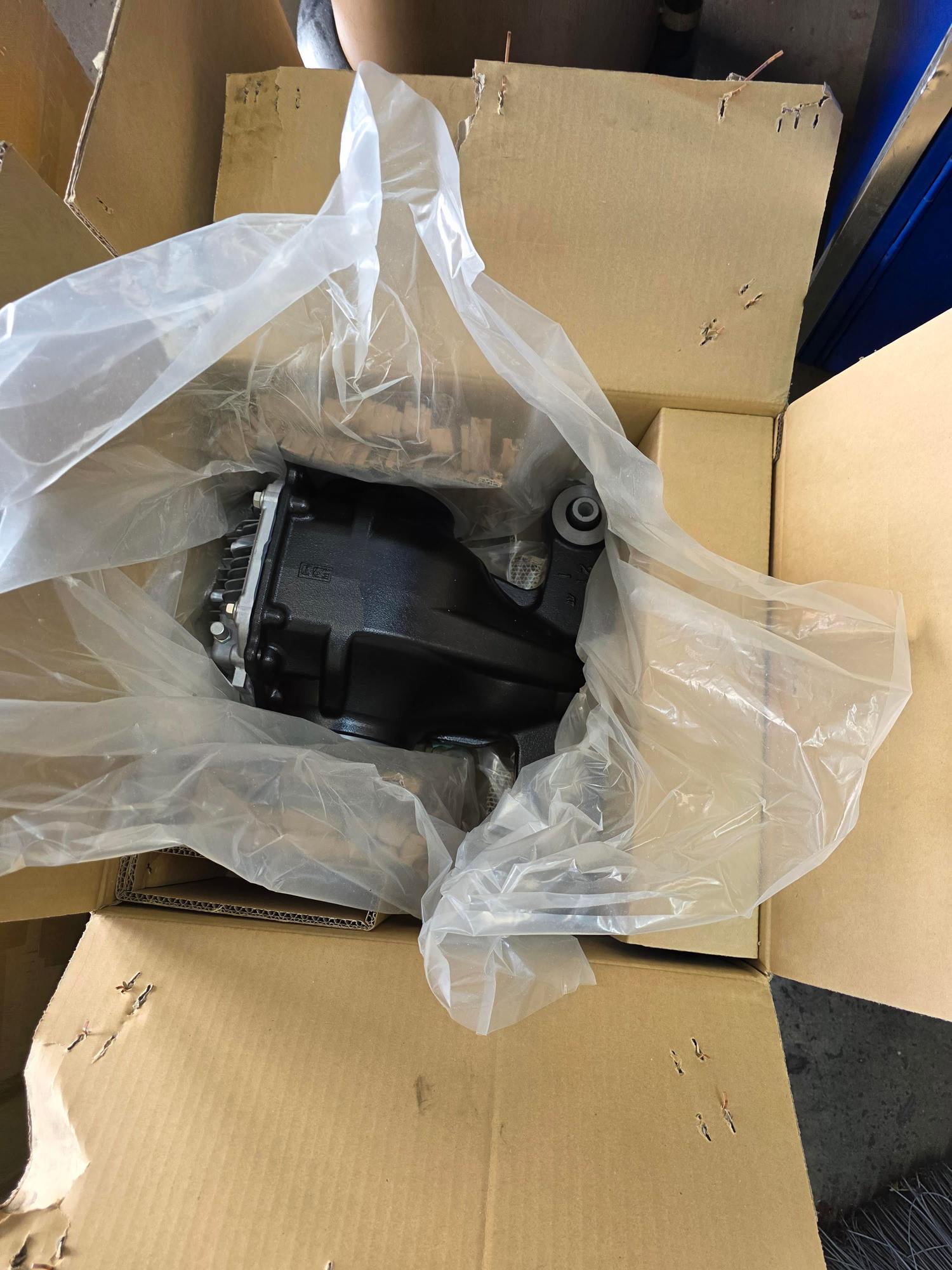

      9. New  Differential
      9. New Differential
      10. Securing new differential for install. This comes with new axle seals and drain plug. Fill plug was not included
      11A. New bushing install on left side (replaced the old one just while we were in there).
      11B. For the right side, after discussion, we decided to remove the counter balance and install the optional 4 mounting point for the differential. This will help reduce diff slop at the expense of a little more wear on the diff and potential noise/vibration (none noticed during initial driving so far).

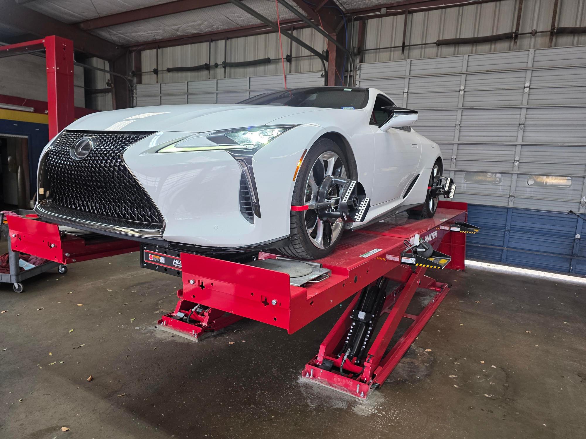

      Alignment completed due to the lowering of rear steering rack
      12. Alignment completed due to the lowering of rear steering rack (My LC500 has the full TRD Aero kit installed and the black chrome grill/bits from the Inspiration Series, I will make future posts about the former.)
