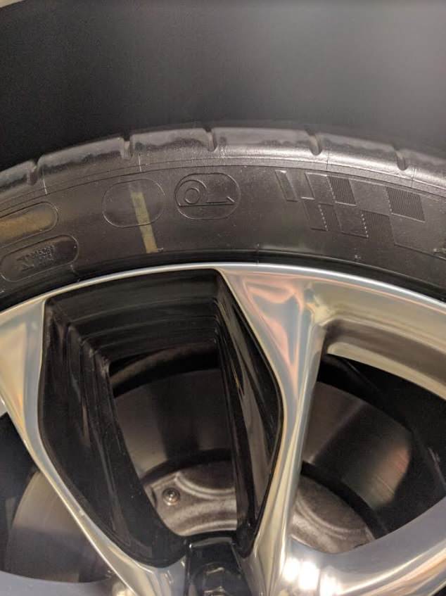

Anyone know what this icon means? This is the driver front tire.
That's the run flat symbol.

LOL, that is the run-flat symbol. Had to know the factory was smarter than than.
Makes sense, never seen it before.
