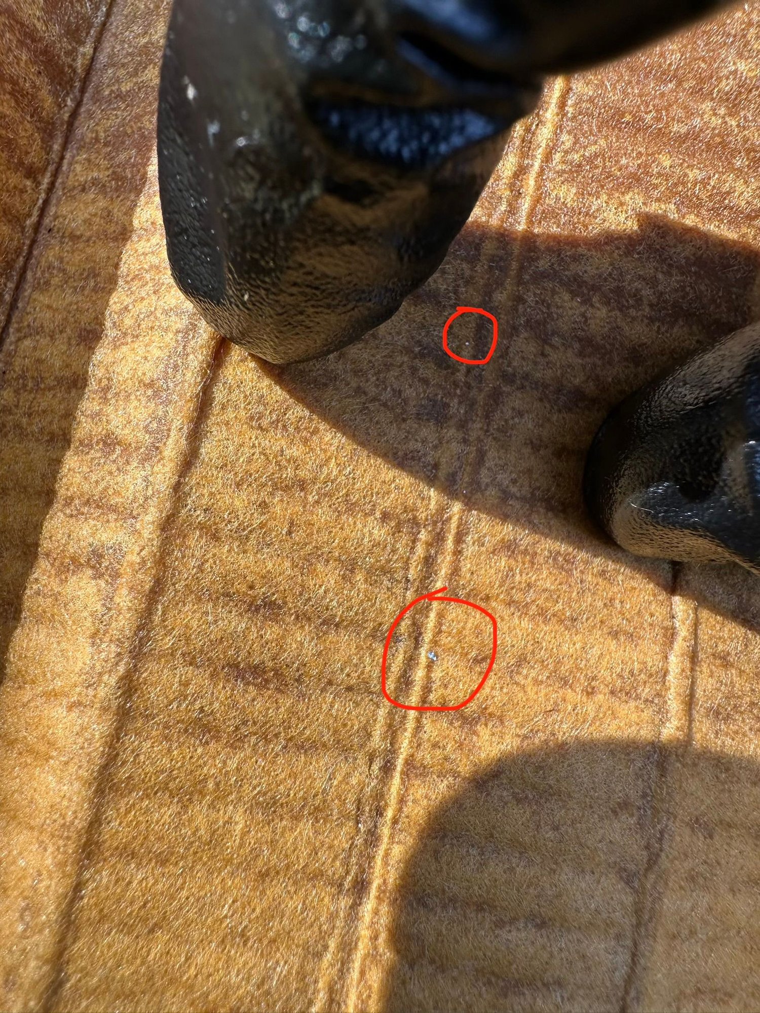

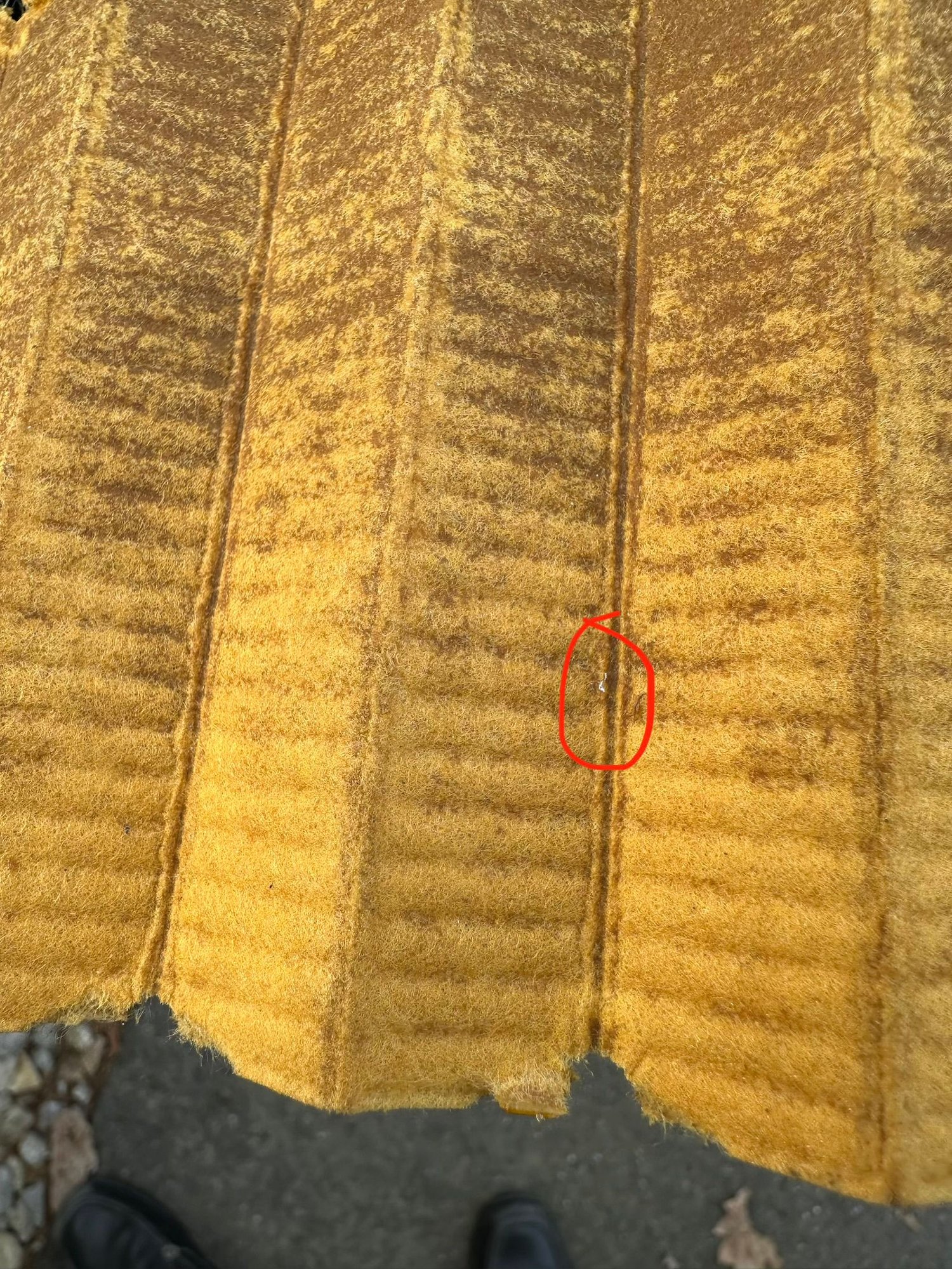

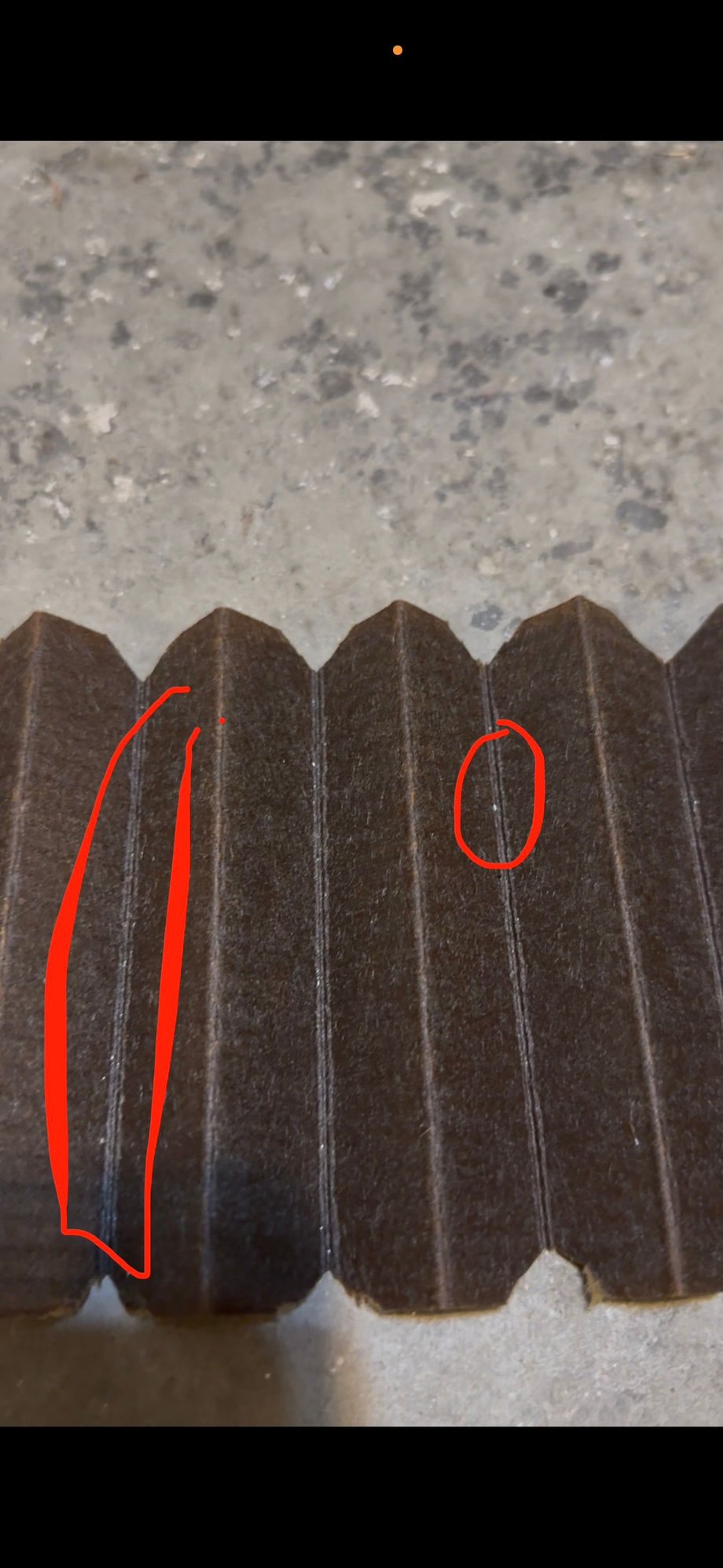

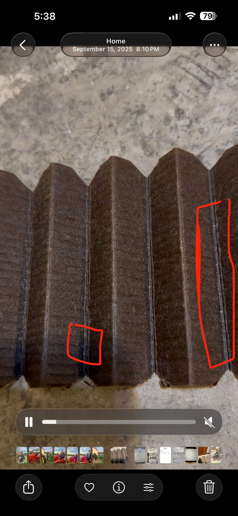

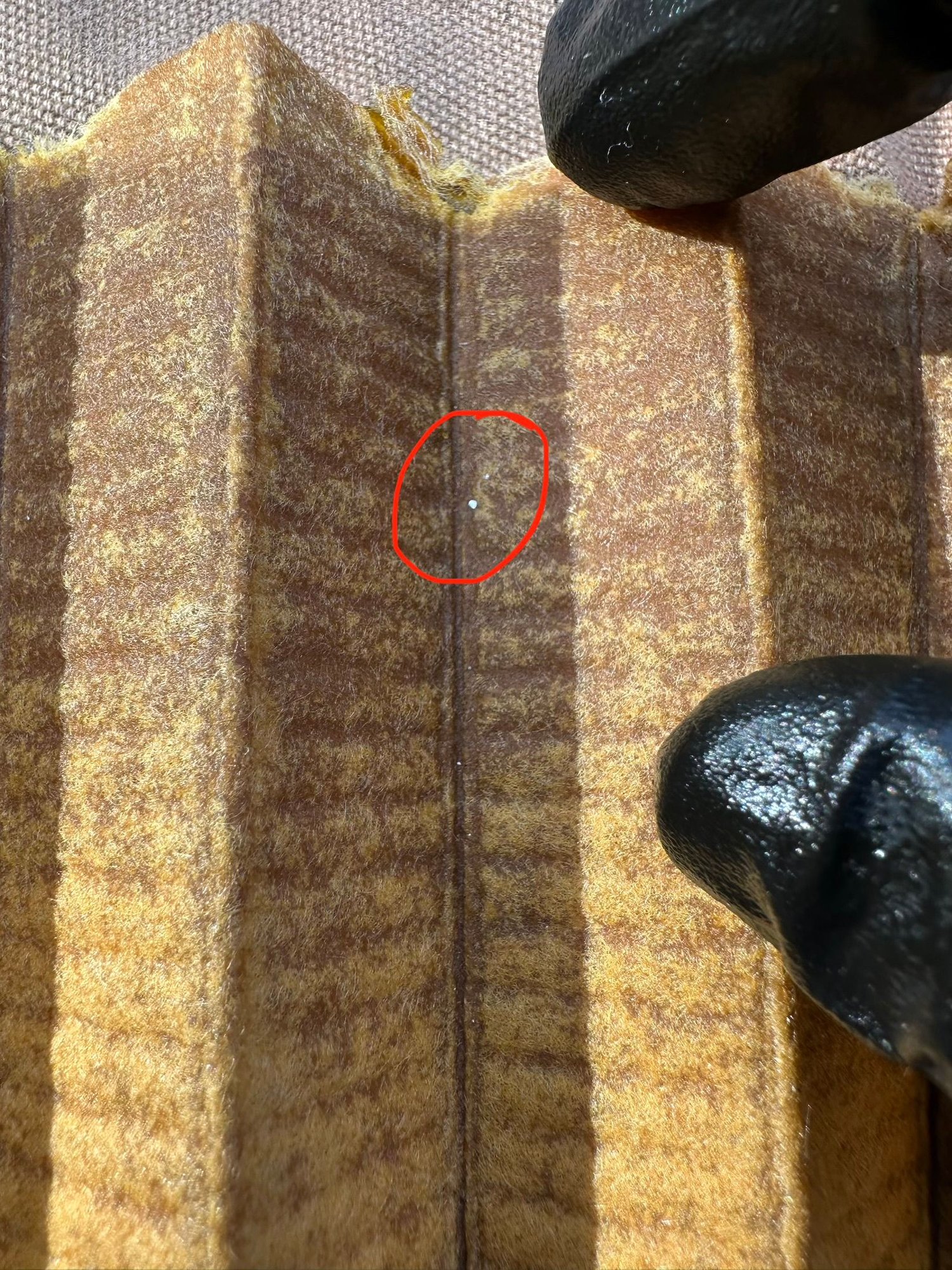

Could be a fluke or could be something bad. If you are a diyer, and of course want to be objective, I would start trending data via oil analysis.
This also isnt your first oil change right?
yes on the oil analysis, already on board a while ago.
Yes, I work deeply well beyond oil changes on cars.
Asked about metal flakes on filter pleats because I wanted to know what you guys see on yours.
To be candid though, I haven’t really been checking oil filters closely until recently with the LX600 engine recall fiasco.
Metal flakes Circled in photos below, dark brown filter is old, possibly unchanged filter (6k-9k?). Light brown filter is 2.5K
