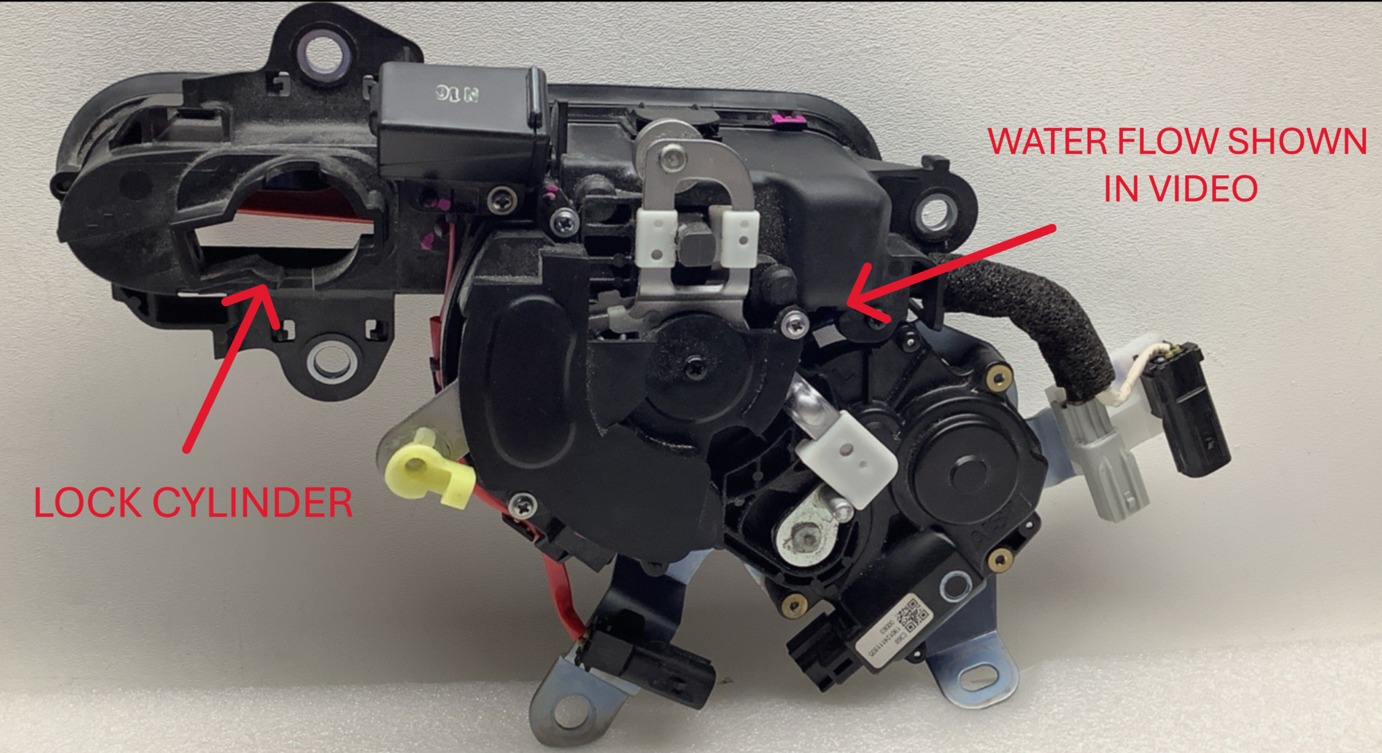

I’ve added another Lexus to my collection a 2020 LC 500. I’m aware that the doors let water leak, I actually saw the video of the water shooting right through the door. My question is, is the water going through where the door handle lever mechanism goes through the panel, or or is the water intrusion coming from around the outside face plate of the door handle? I think I’ve got an idea how to solve this problem. Richard as always thank you for any help.

Yes. But again where is water specifically entering?. Yes we can all see the guy squirting the door with a hose, but do we know where the water is actually entering in? The whole door handle edge? Or from underneath the door handle then bypassing into the door. I guess i’m saying i wanna know exactly where the water enters. The video goes on and shows the water coming from the other side. That’s great, but where is the water exactly entering. One cannot solve the problem if you don’t know where the problem is occurring other than generally saying, the door handle leaks

Reviewing the video, the eBay pictures, and my own car, I’m seeing three openings: one for the lock cylinder, where the water resistance is unknown, and two small square drainage holes in the bottom of the black plastic tray, one on the hinge side of the handle and the other on the lock cylinder side.
Driver Side two openings shown
Lock cylinder installed passenger side all three openings shown
My driver side (above picture is passenger side)

Great photos. These are big help. I’ll pass along my effort trying to stop water intrusion

Last photo of red door handle extended, what is the little hole that the green arrow is pointing to?

It appears to be one of the two drain holes I mentioned. When I shine a flashlight into the hole, I can see the infrared paint on the door.
