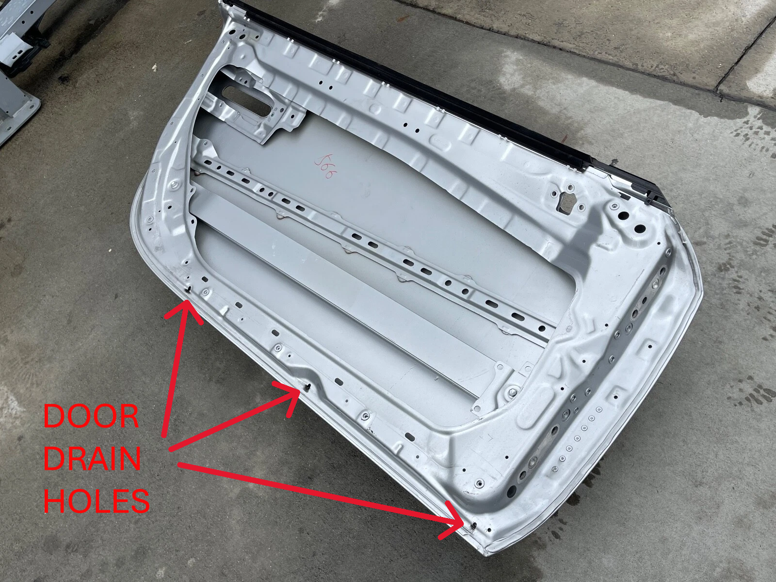

If water accumulates inside the door handles then freezes, the handles won't extend, and you will be locked out of the vehicle.
It is normal for water to drain from the doors after rain or washing the car, what is problem that needs to be corrected? Is water leaking past the interior panel into the car?
