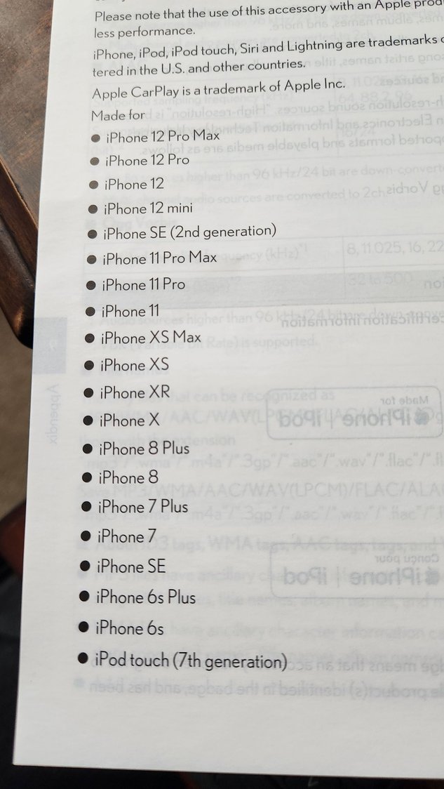

Originally Posted by flohmann
@schafari thanks, that's exactly the real world evidence that I needed! Have you tried any iPods older than the Touch? I have a mix of iPod Classics and Nanos, none of which are recognized in my 2025 LC. I've confirmed that regular USB flash drives work, and I've tried multiple USB cables.
Well, I haven't used my original iPod with an actual hard drive in it for too many years to mention. Its battery is too low to turn on right now, so I am charging it. Once it is charged, I'll try it out and report back tomorrow; however, I do have bad news. On page 222 of the multimedia owners manual, only the iPod Touch 7th gen is listed. . .

I had a chance to test my iPod Classic, which does not work with the 24' LC500. However, my iPod Touch 7th generation works perfectly with the LC500.
