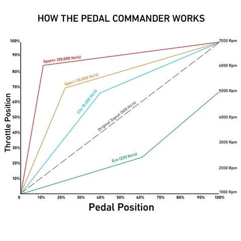

But it's not that the manufacturers limit the throttle input, it's that the pedal controllers manipulate the signal so the 0-100 percent of the pedal can be varied rather than always be the full travel of the pedal. Depending on driving style they can be extremely useful, glad you're enjoying it!
Here's a good graph from Pedal Commander in how the signals get changed:

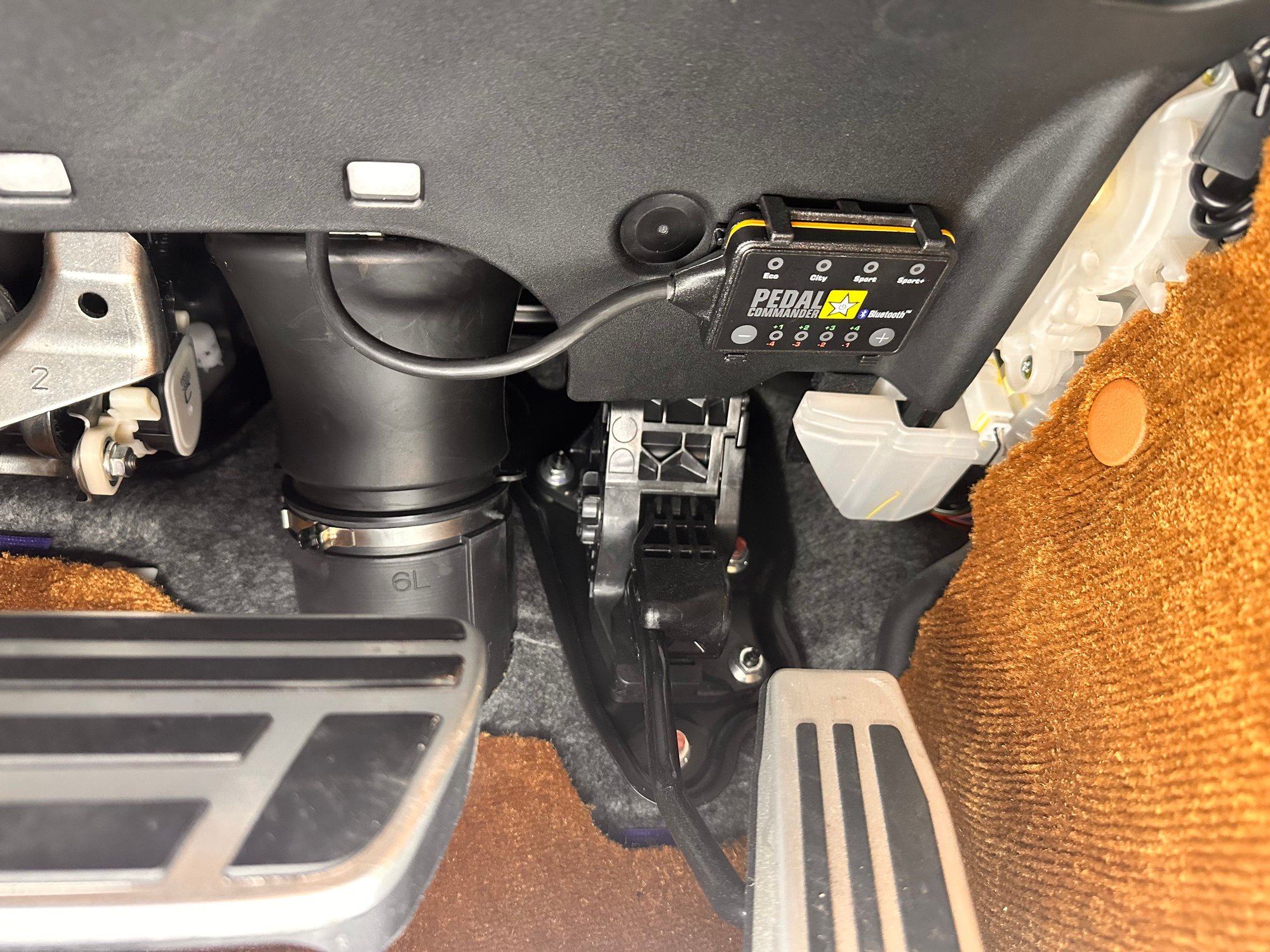

With these devices having Bluetooth, there's really no need for the button to be exposed. I keep my Pedal Commander controller under the dash.

These things don't change anything in regards to engine output. No HP nor torque changes. It does not change 0-60 times at all. All it does is change the amount of pedal travel for the same outcome. In other words, where you normally would press the pedal down with 1" of travel to take off at the rate you desire, now it only takes 1/4" of pedal travel. You are simply not needing to press the pedal down as far as before to get the same effect.
After looking at the graphs, that's exactly what I was thinking. It merely changes the modulation of the pedal.
