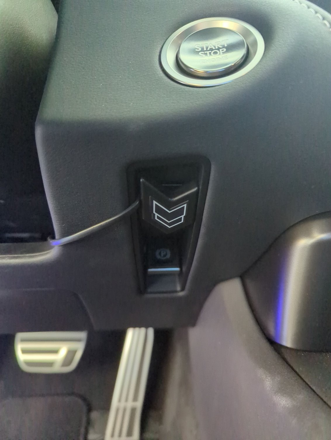

Installed! I can't get the button to stick on any of the leather surfaces on the car. I had the same trouble with the armytrix remote. Even used new 3M VHB but eventually crammed it in here above the parking brake lever.
The connector was very simple if you remove the panel covering it (2 screws and a few clips and the footwell light), but contorting under there sure was tough!

Looks neat an clean.

I'm not loving the wire but I also cant see it while driving so might just leave it.

It blends and is down low.
