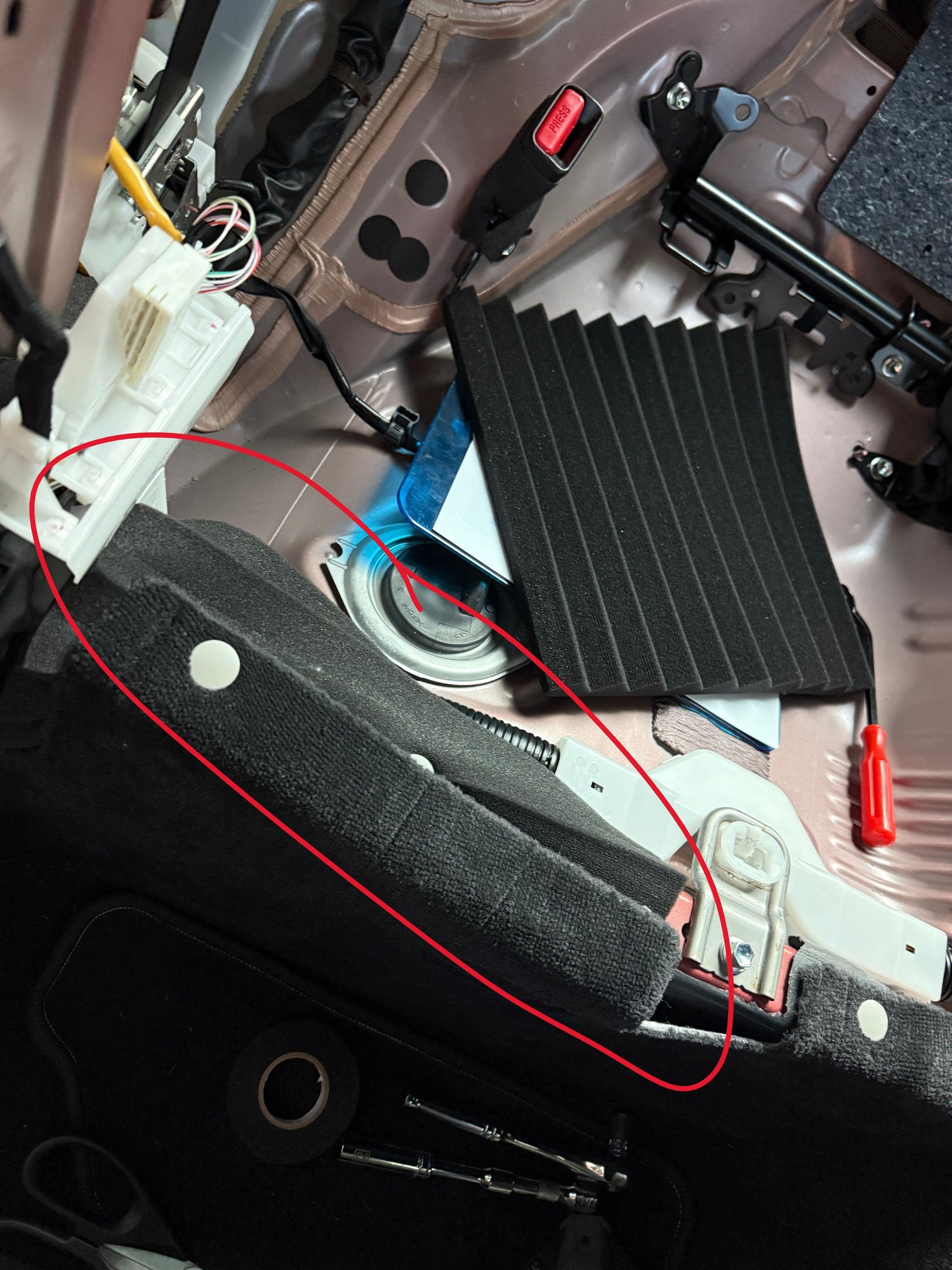

UPDATE on 3/31/25: I brought the car back to the body shop and they found and fixed my problem: The anti-squeal tape they applied to the brace had been worn down and I missed this spot when I re-applied it. They doubled-up the amount of anti-squeal tape and my car is back to not having any noise. The good news is that it took my only 15 minutes to remove the backseat to get to this spot, so I'll re-apply the tape every 4-5 months when the sound returns until I find a more permanent fix.
UPDATE on 3/24/25: The squeak has returned despite the fix below, so this is not a long-lasting solution. I'm keeping this up since I'm not done in my quest to fix this noise and will update this once I've found a better solution.
I was able to fix the squeaking noise coming from the rear brace and pillar that is fairly common on the early model year LC 500's. It took me just over an hour to do and I'm not very handy (I don't do oil changes or brake jobs but will tackle easier mods). It was mostly very easy and the results are worth it to me.
The reason I did this is because 1) the noise bothers me and 2) I didn't want to take it back to the body shop every six months to adjust the bolts, which is also expensive. I'm sure the squeak will return, so when it does I'll take an hour to fix it again myself.
Here's how I did it. First, I heavily leveraged the information in this thread on the issue and potential fixes: https://www.clublexus.com/forums/lc-...ng-else-5.html. I then used the instructions in this thread: https://www.lexusownersclub.co.uk/fo...lunking-noise/. The problem was that it didn't show the specific steps, so I figured I'd be the guinea pig and experiment with my own car. Finally, I used this resource to figure out how to remove the rear seats and side panels: https://www.lexus-tech.eu/HYBRID/HVD...00h_GWZ100.pdf (starting on page 38).
With that, let's dive into how I fixed my squeak:
1. Remove the rear seat cushions by pulling up on the front of the seat like you see here (you may break the clip that the seat attaches to (I did) but this is a cheap and easy part to get at the dealer):
[img alt="Rear seat cushion removal
"]https://cimg2.ibsrv.net/gimg/www.clublexus.com-vbulletin/1262x1296/removing_rear_seat_cushions_99e0429af2ba174b70b2a78e96dda9eff07cc869.png[/img]
2. Remove the seat back cushions with a 12mm socket and socket extension. Note that I only did this on the passenger side since that's where the noise was coming from. I did not do this on the driver side of the vehicle):
3. Remove two clips securing the side panel by using a flat head screwdriver to pry up the center piece or a panel removal tool (this shows the driver side panel, but you'll see where the clips are on the passenger side):
4. Remove the passenger side rear side panel by pulling out the seatbelt cover with your hand, then pull on the panel in the areas indicated below (no tools needed as the panel will basically pop out pretty easily):
Here you can see where to remove the clips (yellow circles) and where you need to pull on the side panel to remove it (red circles):
5. You'll also need to remove the rear portion of the scuff plate by pulling up on it (very easy):
6. You can then pull up on the panel and remove it from the vehicle:
7. You'll now have access to the brace that runs right behind each of the front seats and stretches from door-to-door. The problematic metal piece is located under the carpet. To access it, use a flat head screwdriver or a panel removal tool to pry up the carpet under the white clips (circled in yellow below), which will expose the six bolts that attach the squeaky metal bracket to the cross brace and b-pillar (circled in red, behind the carpet). Loosen these six bolts:
8. You'll then want to slightly pull out the white plastic piece that's covering the other three bolts that attach the metal piece to the brace and b-pillar. Note that it's connected the wire circled in yellow below that is easy to remove, but I couldn't figure out how to disconnect the seat belt wire (circled in green, which is behind the black loom). Removing the seat belt wire would've made removing the three belts (circled in red) behind the white plastic piece so much easier, but I was still able to get enough clearance to remove the bolts without removing this wire):
9. You'll want to remove the three bolts in red above using a 12mm socket, as well as the six other bolts that secure this metal piece to the brace. I then applied "squeak reduction tape" to as many areas as I could behind the brace:
Amazon Amazon
, then white lithium grease to the areas where I couldn't. I then screwed them back in using the order outlined here:
10. Before putting everything back, I also cut some sound absorbing material and stuffed it behind the white plastic connector that covers the three bolts on the b-pillar, and just under the carpet over the brace. Here's the product from Amazon:
Amazon Amazon
, and here are the photo's of the sound absorbing material stuffed behind as many places as I could find:
So far the noise is completely gone and it makes driving the car so much more enjoyable! I'm sure it will come back in the next 4-6 months, but I'll re-tighten the bolts again until this no longer works.

I've got some unfortunate news: my fix didn't last nearly as long as I was hoping for, as the noise has already started to return
So I'm going to take it back to the body shop to see about welding, but @Brinylon it sounds like the welds didn't fix the squeak for you so I'm a bit lost as to what to do next. I'm wondering about removing the brace completely from the vehicle, but know that's not a great idea since it may cause issues elsewhere.

I dropped my car off at a Lexus certified shop today who originally applied the anti-squeak tape which fixed the noise for about four months and asked him about welding. He mentioned that if you use heat to weld the metal components, it could negatively impact the integrity of the metal so he was reluctant to go down this route.
He's going to contact Lexus again to see if they have any more advice on how to fix it, but I'm not too optimistic about that given that it seems that no one has found a permanent fix yet.
The good news is that it took me about 10 minutes to remove the interior panels to access the area since I've done it once before. So if the solution they come up with lasts another 4-5 months, I could pretty easily repeat that process quickly to address the noise.
I'll update this thread as I find out more, since I'm determined to find a solution to this problem since I love everything about the car... except this damn brace squeak!
