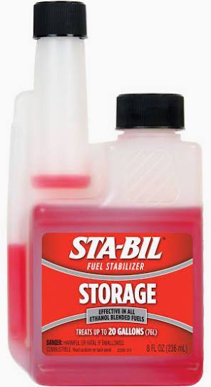

I put my LC away every winter here in PA. I connect the trickle charger,put fuel stabilizer in the tank & put 40 ibs air pressure in the tires.

Full wash/clay/wax/c-coating, interior wipe down, fuel stabil on full tank of premium, check/top off other fluids, inflate tires to 3-4PSI above factory 'cold' setting', battery tender, (optional) car cover -> I have full PPF

This:
