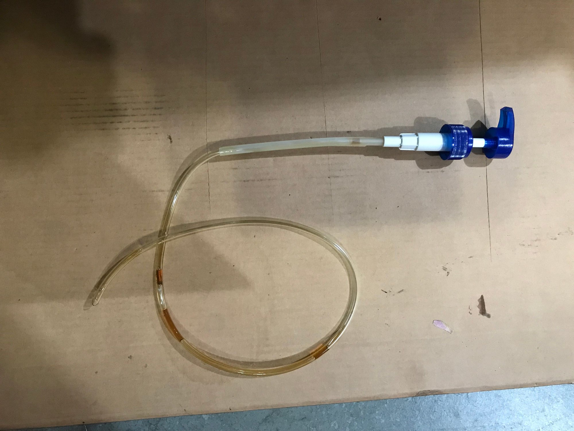

This is what I made to quickly take the oil back from engine. Had to use it twice already. Next time I will let shop manager know that they have to check oil 3 times before getting back to me.
I would so ***** slap the service manager with. You know there's 1 single little Japanese guy who's whole job is to hand assemble that engine.
And you all, you're Zero for Three even getting the right amout of oil in it. Oh and please forward that message to All your techs too.
