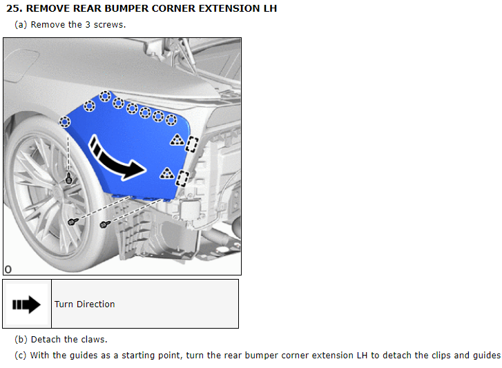

It is mostly held on with clips. You can try tightening the screw behind the fender lining or spray plastic-safe Teflon lubricant into the joint and gently push on it to work the lubricant into the creaking area. Any residue on the exterior is harmless and can be washed off.

Diagram of clips (dashed circles). Even the pressure of someone leaning up against the panel is enough to cause the clips to start squeaking.

where you find the diagrams? Is this from the service manual?
That is from the Lexus repair manual, when buying a CPO Lexus the dealership doesn't have time to do as thorough inspection of the car as I want. Nobody knows how the previous owner treated the car. I don't trust the dealerships to work on interior and exterior trim without making something worse. This is from years of experience on both new and used cars. Thus with every Lexus I buy, no matter how new ('22 w/ 6,500 miles) I get the manual and do the work myself. Mechanical components I leave to the dealership as I don't have the space or tools.
