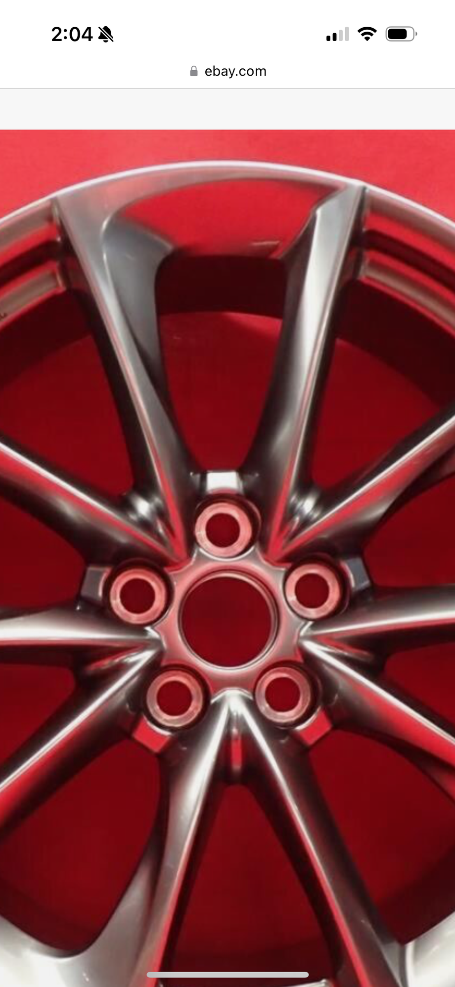

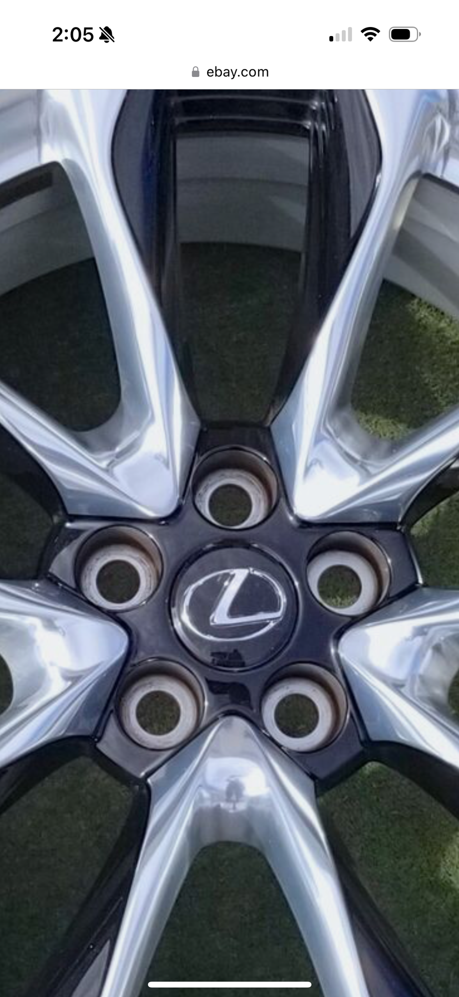

I just got off the phone with my dealer’s parts department. He asked the master tech and he basically said that he can’t guarantee the lug nuts wheels can be mounted with the lug bolts. He’s unsure that the surface of the lug nuts wheels will mate with the bolts. Basically, he can’t recommend doing it because if it doesn’t work out, I would lose a lot of money.

And actually you can see the difference in the lug nuts and lug bolts surface are not the same. So if you’re thinking of using previous MY wheels on the ‘24 LC500, beware!
Lug bolt style. You can see there’s an indentation/ step for the bolt to sit in
20” lug nuts. Surface is flat.
21” lug nuts. Surface is flat.

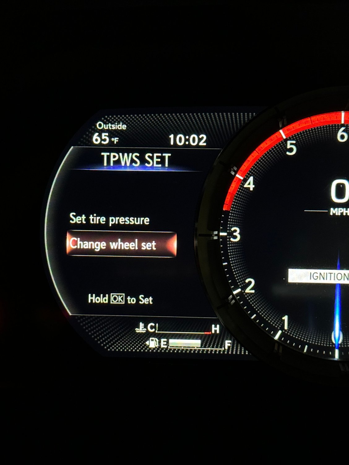

Does anyone know: if you use two sets of wheels (summer/winter) whether or not you need to have the dealer or a tire shop reset the TPMSs to the LC everytime you swap?
On my ‘24 LC, there’s a change wheel set on TPMS.
So they did think of people having two sets of wheels unlike my GSF where they removed this feature.
Thanks very much! That's great to know. I had read somewhere else in this forum that you needed a special tool and some expertise to reset the LC to the wheel TPMSs when you switched out wheels. Maybe it was for an older MY.

I live in MA as well and went with a separate set of OEM winter 21s with all seasons and non-OEM TPMS. I did try to get snow tires before I did this setup but was unsuccessful in getting tires (out of stock; no sizes etc.).
With respect to resetting the TPMS, below are the steps that I used and so far no issues with both OEM and non-OEM TPMSs. I just swapped out of summer into the all seasons.
Start the engine and keep the vehicle in PARK.
  1. Select “Settings” (gear icon) using the steering wheel LEFT/RIGHT buttons.
  2. Select “Vehicles Settings” then press and hold the center OK button.
  3. Select “TPWS” (Tire Pressure Warning System), then select “Change Wheel.”
  4. Press and hold the OK button until the TPMS warning light flashes 3 times.
  5. Drive the vehicle for 10-30 minutes, staying above 25mph when possible, and the light will turn off once the sensors are registered. Note: Refrain from reversing and driving in heavy traffic during the relearn process.
    Park and allow the tires to cool for at least 3 hours.
After the light has turned off, place the vehicle in PARK and select “Settings” again.
  1. Select “Vehicle Settings” then press and hold the OK button.
  2. Select “TPWS”, then select “Set Pressure.”
  3. Press and hold the OK button until the TPMS warning light flashes 3 times.
  4. Drive the vehicle for 10-30 minutes, staying above 25mph when possible, and the light will turn off once the current tire pressures values are accepted.
