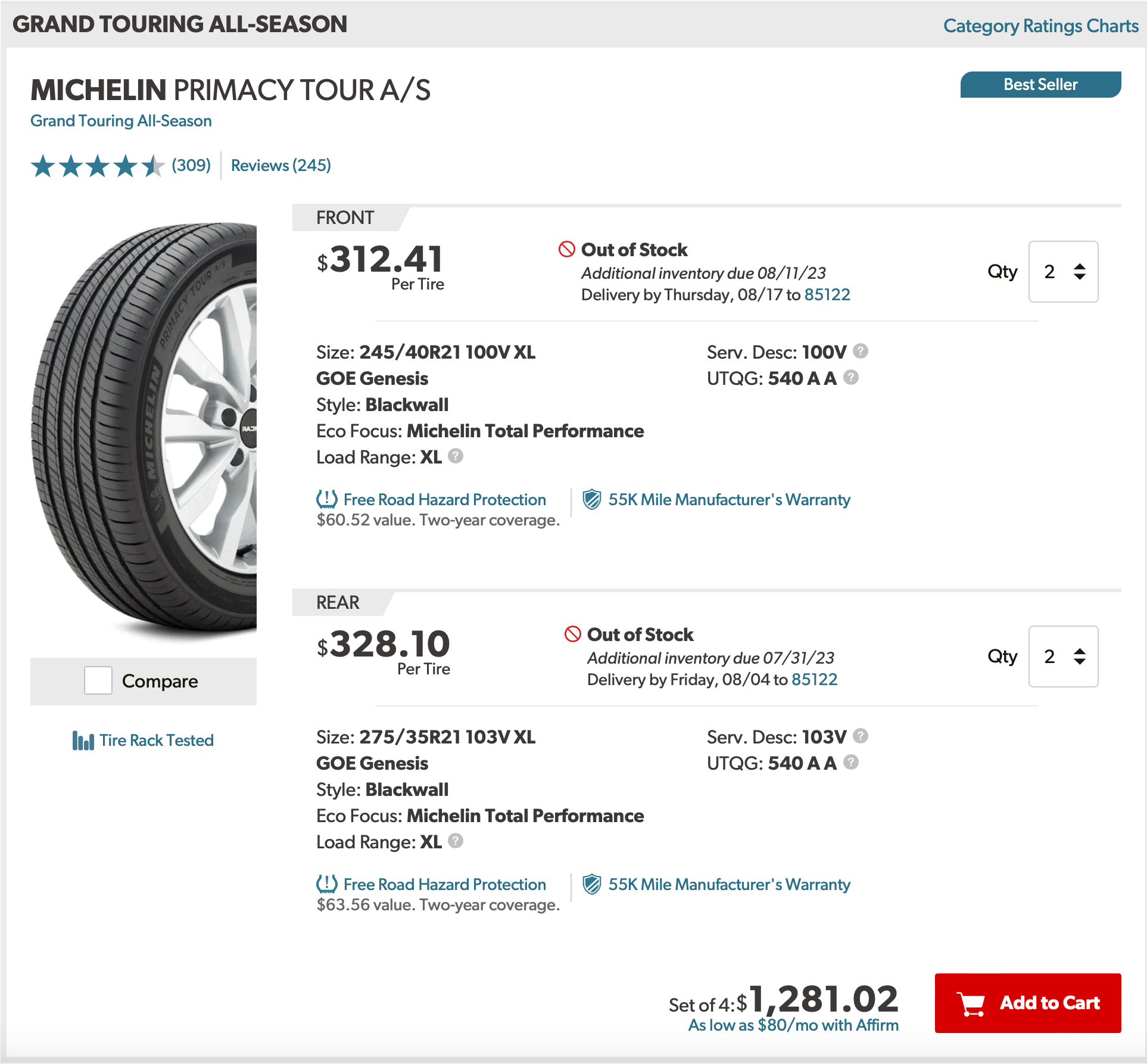

I am considering a 2018 LC500 for my wife. We live in KY. The car would not be driven in snow, but it would be driven in colder weather and rain. Are there all season tires available for the 21" wheels? Tire rack does not list any. Tire discounters list only only the Bridgestone Alenza 001.

Tire Rack does list the Alenza and also the Michelin Primacy Tour A/S, but the Michelin is not an RFT, so yes your selections are limited in an All Season RF tire.

I asked the same Q after I saw tirerack had no good all-season options and got this reply from @redrocktom :
"As to your question on all-season tires, something I will probably need also. My choice would be the Michelin High Performance Pilot Sport all- season 4, 255/40ZR21 front and either the 275 or 285/35ZR21 rear. A little wider than stock, but will fit the stock rims fine. The 285's will be closer in diameter to the 255's so that would be my choice."
I've had Pilot Sport A/S's in the past and they were great, so when my dunlop run-flats are done for I'll switch to them. You just have to enter the correct sizes manually rather than relying on TireRack to suggest them for the LC.

^^^^You are correct on the sizes, but unfortunately the AS4 does not come in the 285/35/21 size. So it would have to be 255/40/21 in front and 275/35/21 in back. And again, not an RF tire.
