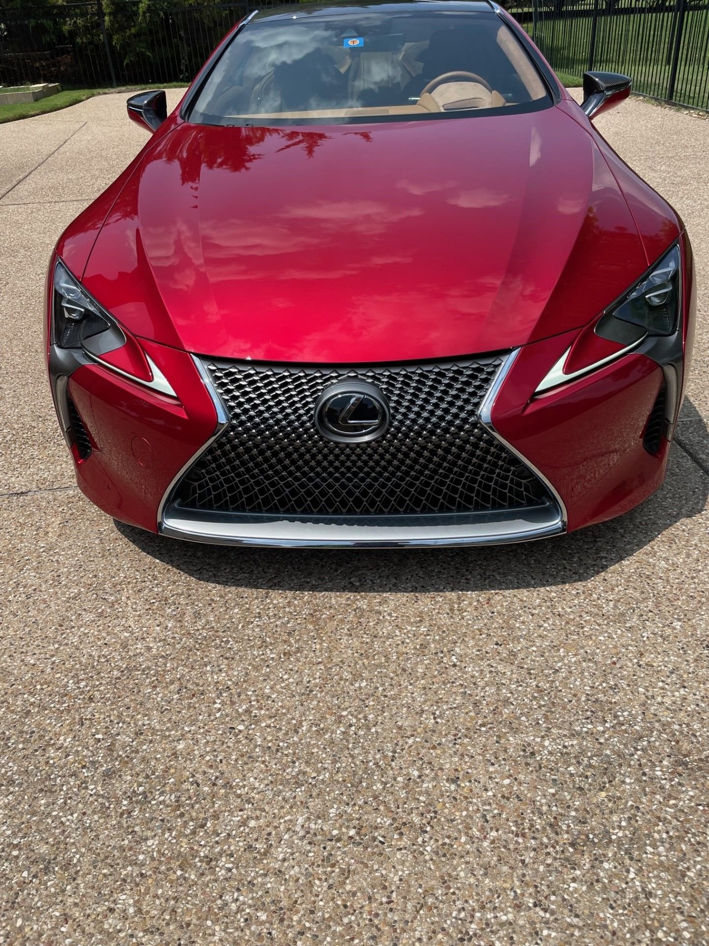

After seeing the pics of the superb install done by DFW-SC430 earlier in this thread, I decided I needed to up my game and place the camera on the inside of the grill, or at least make the attempt. Although I thought about doing this originally, I had assumed that the webbing of the grill would obstruct some of the camera's view. Today, I proved that I was wrong.
Here are the pics of this most recent iteration of the camera install.

Looks good. Where will you place the screen?

Originally Posted by sickpuppy
I guess I'm confused Why are you folks going with a kludge when there is a an aftermarket system available when installed by a qualified technician looks and acts like it was factory installed
I can only speak for myself.
Soon after I bought the car in February of this year, I took it to a Car Toys (local car audio retailer/installer) location and inquired about getting a camera in the front. The salesperson did some checking and, although he said that they used to do such things, he ultimately told me that he had nothing to offer me.
So, I just kept my eyes open for a solution. I came across a post in a Facebook LC group in which there was a description of a DIY front camera install. I asked some questions of the LC owner who made the post, liked the answers that I got, so I merely duplicated his efforts - until I made some improvements.
About the only advantage I can see to having the integration done professionally, is getting the camera view on the car’s infotainment screen. There is no question that that is the ideal. I’d love to have that level of integration. However, after seeing the degree of disassembly involved in installing such a system, I am simply not willing to subject my car to all of that. It’s not happening. My front cam is now just as discreet as any that I have seen. My screen is under the armrest, so it’s not visible unless in use.
Everyone has their own perspective. To each, his own. I think it’s great that there is a solution that will utilize the infotainment screen. However, had the sales person at Car Toys had such an offering, and had I known what would have been involved, I would have passed on the deal. I just don’t like the amount of dismemberment that is needed to meet the objective. But different views is what makes the world go ‘round.
