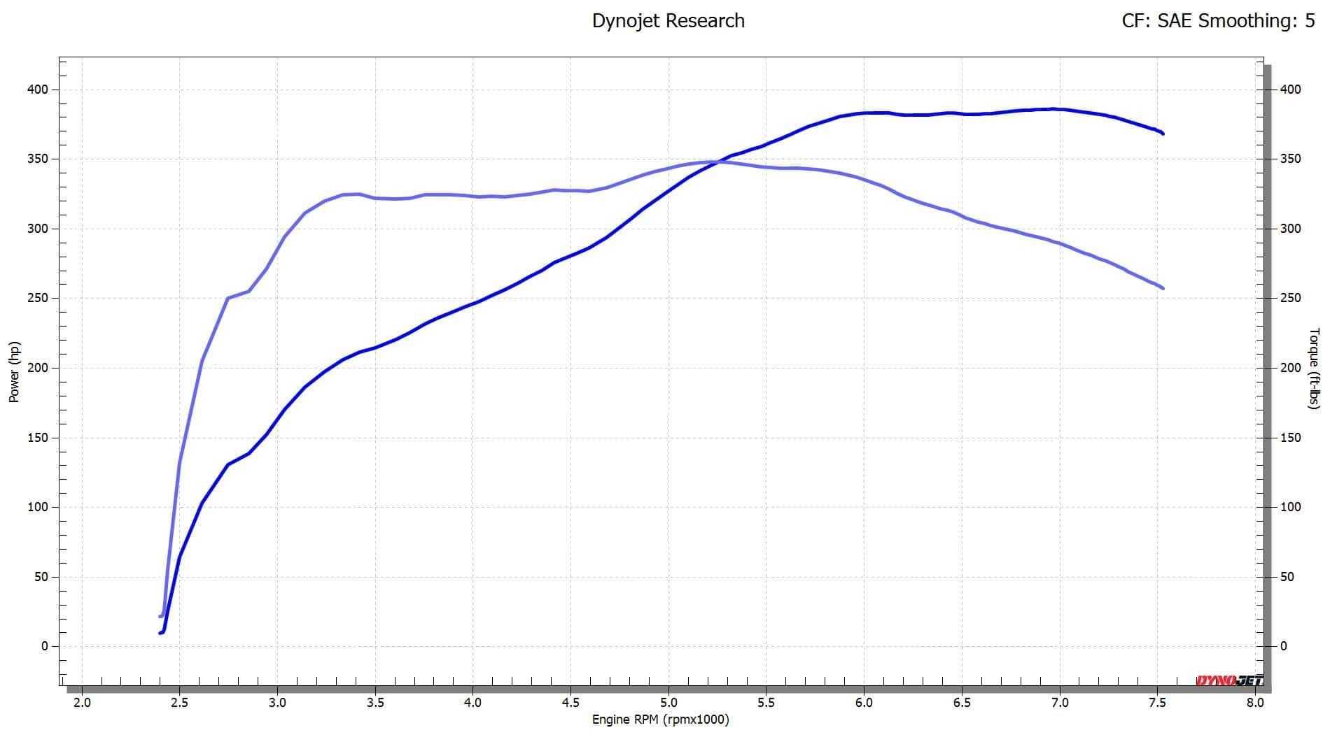

Just wanted to add some information to this thread. My car has been Tuned by Loi for over a year now. I typically do quite a bit of 1/4 mile racing. We started off at 7200 redline. Later moved up to 7300, 7400, 7500 & 7600 RPM redline. Haven't encountered any sort of issues or problems at all. I'm running Pennzoil Ultra Platinum 5w-30 for the engine oil.
Also wanted to add my ISF has a 3.7 rear diff, engine oil and transmission oil coolers. Dyno chart below is in 5th gear.

Oil isn't the big issue for 10-12 second bursts at full power. Redline in these engines will be dictated by valve springs more than anything else, so what you're saying is the valves haven't floated sufficiently to be a problem with the tune(s) you are running. You really won't know what the oil impacts have been until you pull it apart and do some detective work.
This. Valve Float. Is what I have just about always seen on stock car and bike engines that blew due to high RPM over Rev. Seems there is no definitive on it. One day they just let go. Tear it down and find out 1 Valve just let go and chunked metal all in. Even seen them go over rev'd on the Dyno.
In addition on the Dyno, being that cars and bikes shift, over revving past peak hp can get you out of the idea power shift point at shift, and get you out of a peak powerband. Basically you can overrev shift and essentially go slower on WOT from gear shift to gear shift. If you get out of that peak powerband shifts point.
