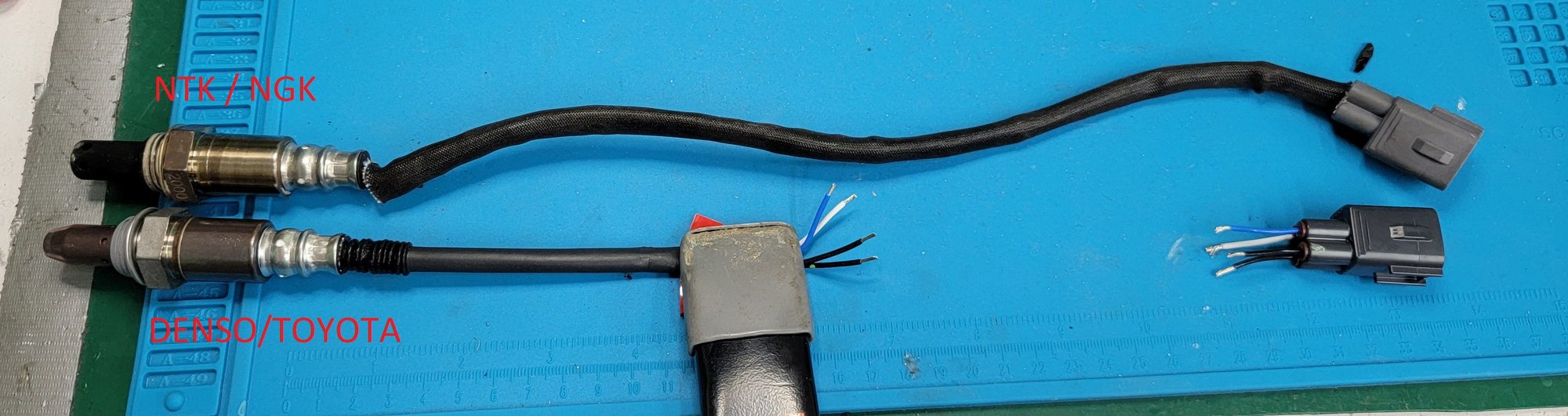

Got the Denso sensors in and the harness is about 5 inches shorter than the NTK. Looks like I'm going to cut/splice these longer. I'm not running extension harnesses again and there's no way I can extend the other end of the plug without a lot a removing things.

Old Dec 8, 2021 | 02:10 PM
  #59
LILEVO's Avatar
LILEVO
Joined: Sep 2005
Posts: 716
Likes: 334
Finished "extended" Denso/Toyota sensor. Soldered, heat shrink, finished with Tesa tape
