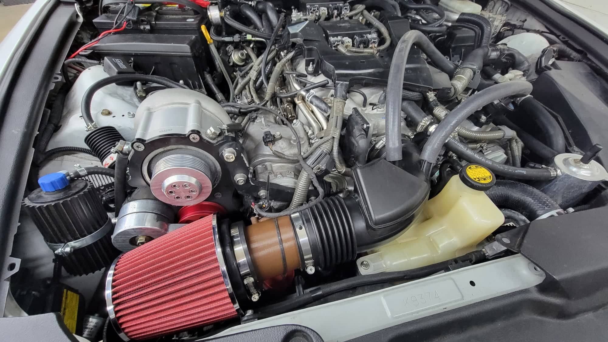

Well this is a challenging situation. I really expected the sensors to make a difference. It’s also not easy to go back to the stock tune for you with your mods, which would sadly be my next consideration in the process of elimination. That or a leak down test. My biggest deficiency is diagnosis though.

Shouldn't be too bad. I can swap the stock injectors back in about 30 minutes then load the stock tune. That should be good enough for driving around in vacuum. I've been trying to get revised tunes from RR for the good part of the year with no luck so at least this way I can rule the tune out of the equation.

It’s a good idea. You will need the stock MAF. Idk if the supercharger uses it. I’m sure you checked for silly stuff like boost leaks, etc.
Trying to eliminate the entire SC and tune as a variable will be helpful. At this point, it’s a process of elimination, unfortunately.
Im glad you have lift access at least. That helps sooth the pain.

Yeah it still uses the stock maf down near the passenger fog light where the air filter is

Forgot about the larger diameter MAF pipe. Need to source a 76mm MAF tube and rig something up. Those are weeks out from China, so I stuck the airbox back on. Will get the car on jackstands and drive the thing in the air tomorrow.
