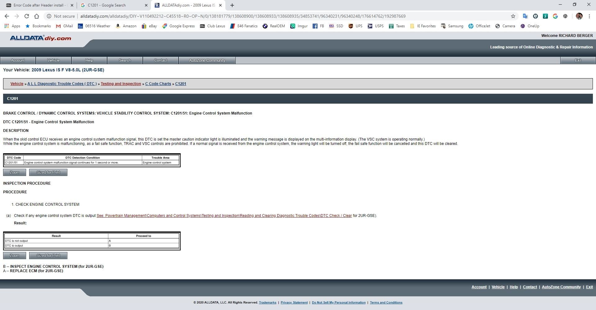

Old Jun 16, 2020 | 05:33 AM
Rickna's Avatar
Rickna
Joined: Mar 2014
Posts: 2,020
Likes: 276
From: ConnectiTAX
This is serious. ALLDATA DIY says to replace ECU.
Start with removing the O2 sim. make sure there are no shorts, etc.
