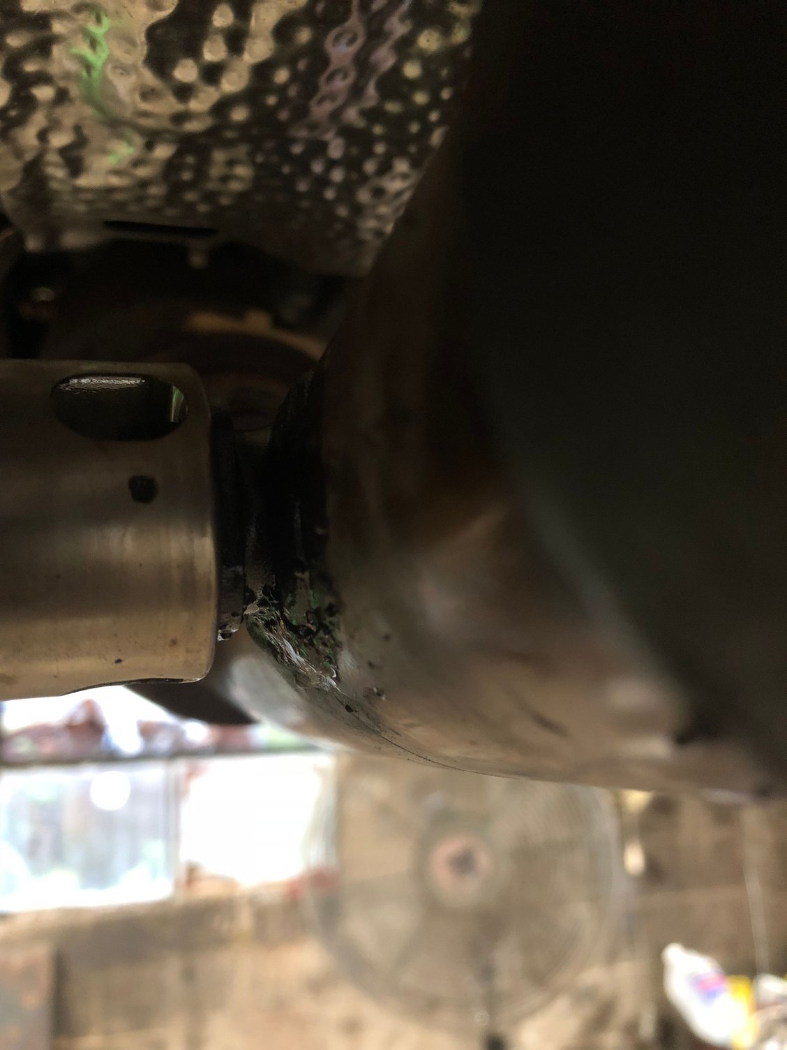

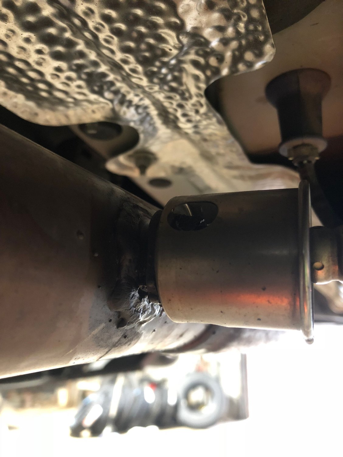

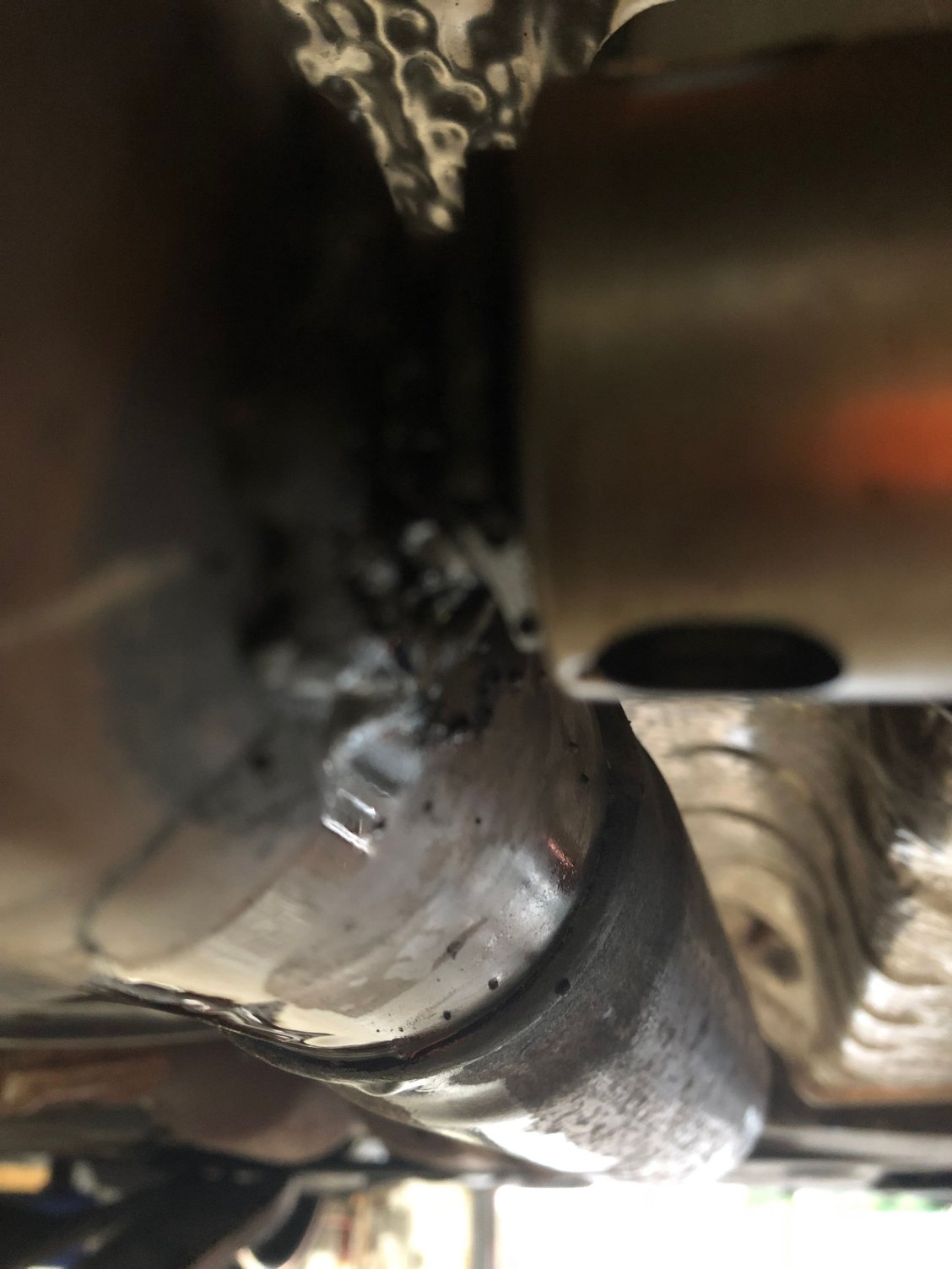

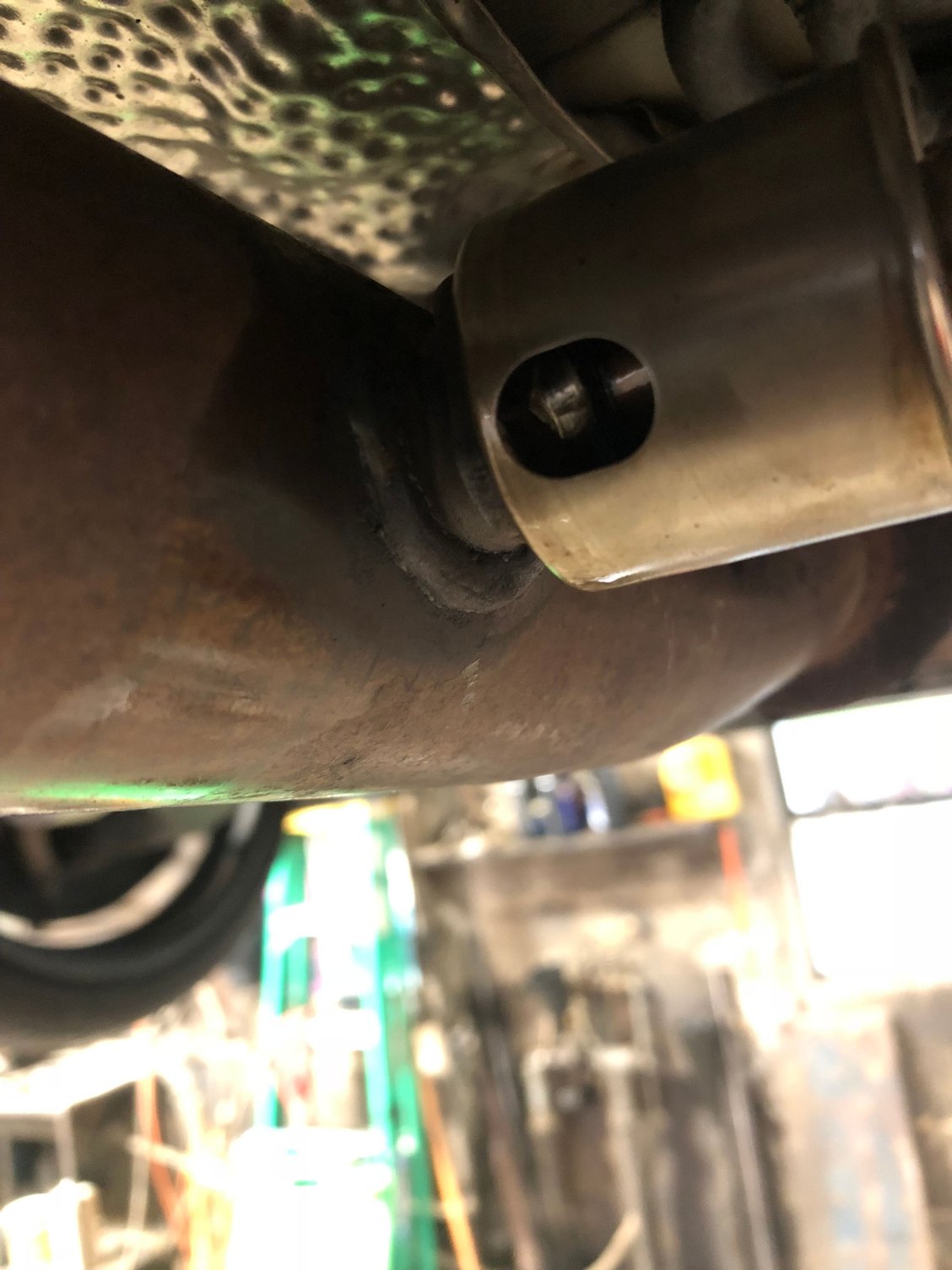

Thanks for all the help and the recommendations. Got the Borla put on last night, passenger side sensor came out with the impact, driver side did not. It seems that there may have been a small leak at some point prior to me owning the car, and someone welded it shut. I have pictures to show the differences. I will post to see what you all think.

here are the photos
