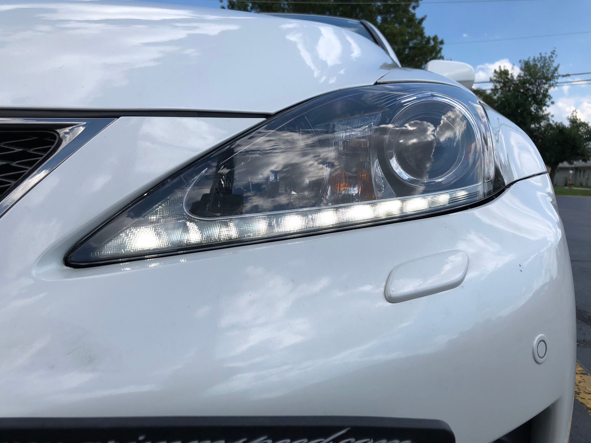

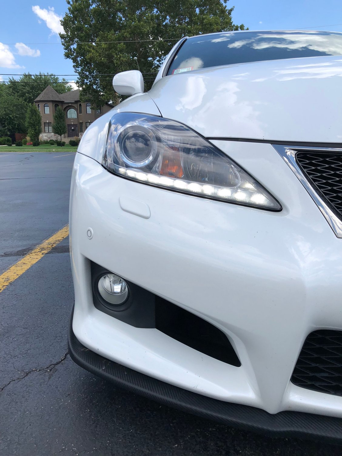

Depo LEDs

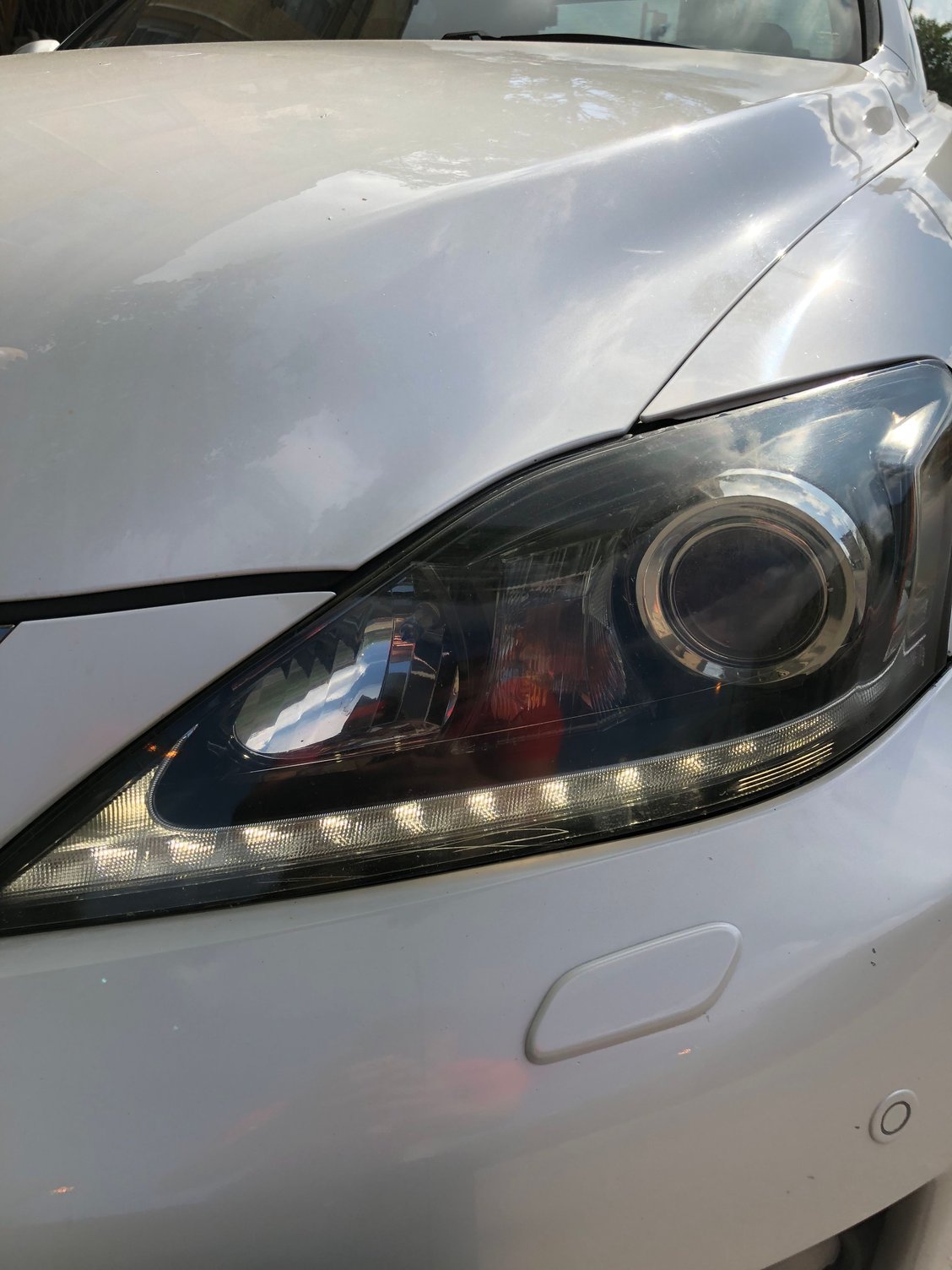

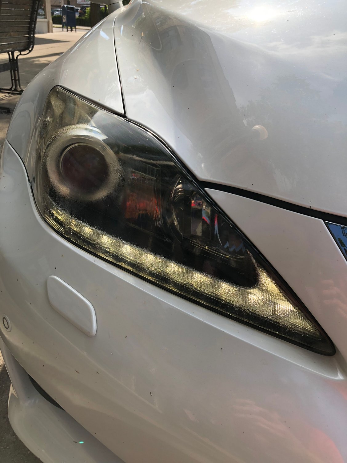

OEMs

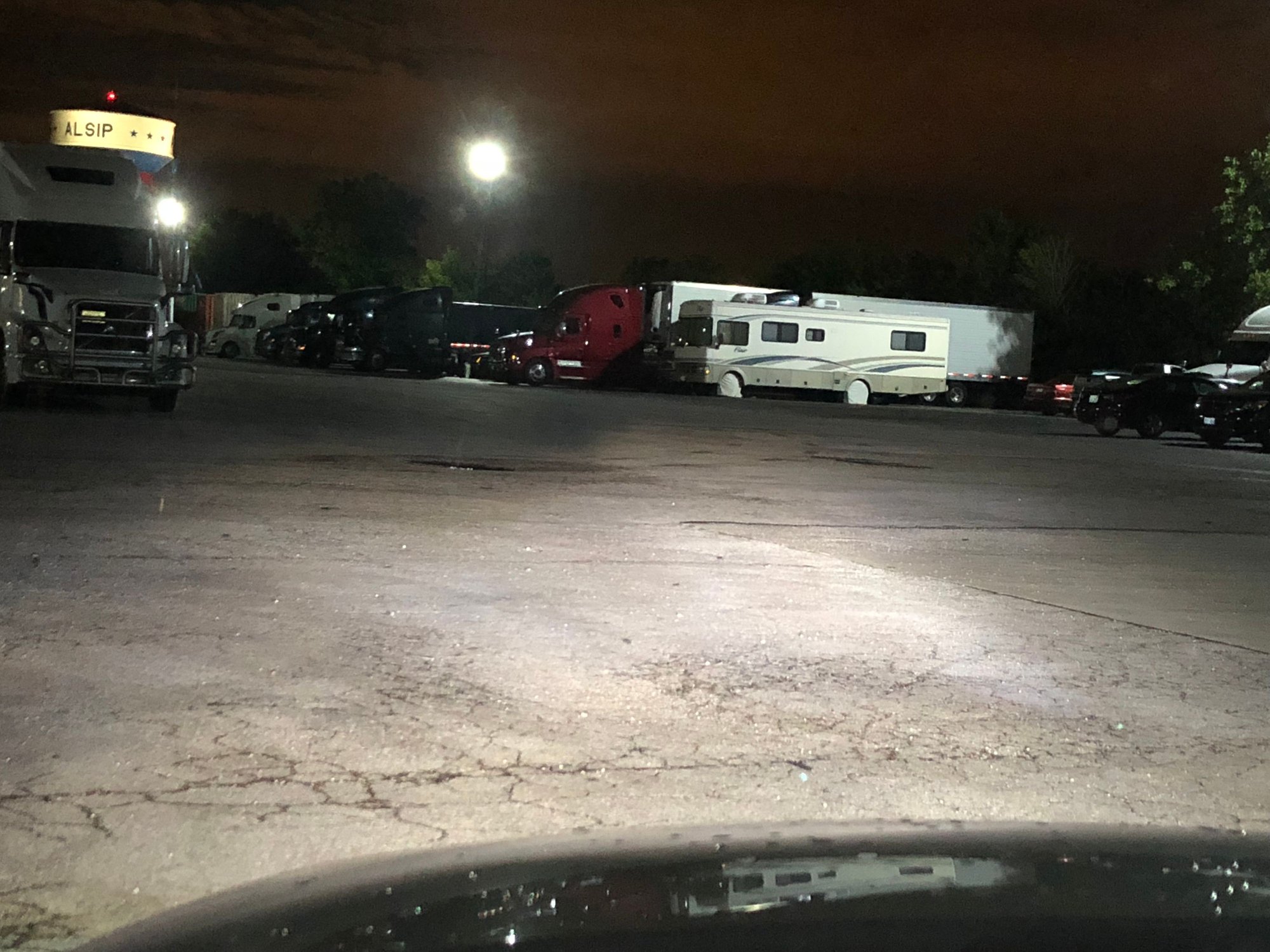

Here’s the cutoff on the projectors with 6000K bulbs

You don't have any wall shots? The beam angle looks low too btw.
