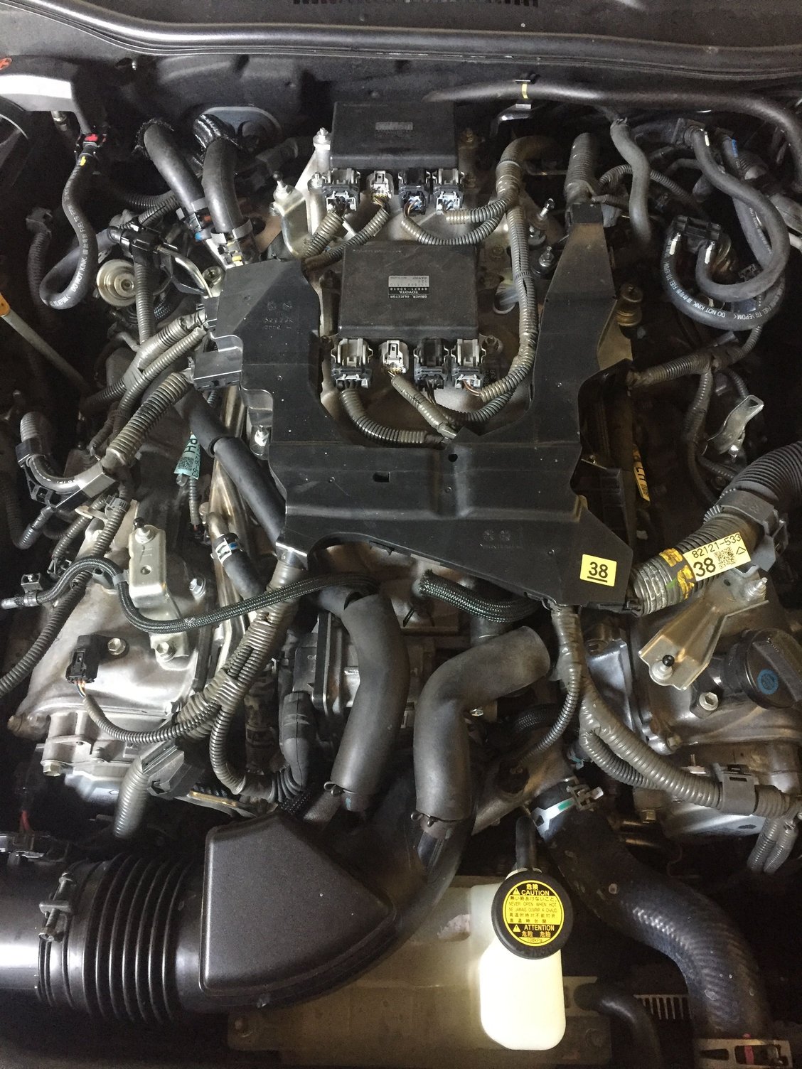

I haven’t checked yet, but will today...

Does that look normal?

From: South Carolina
Yes. A trashed one typically is wrapped in electrical tape. They must have started adding that to the warranty recall repair. Mine was in about 30 different (taped together) pieces and I’ve seen numerous people complain about it.
