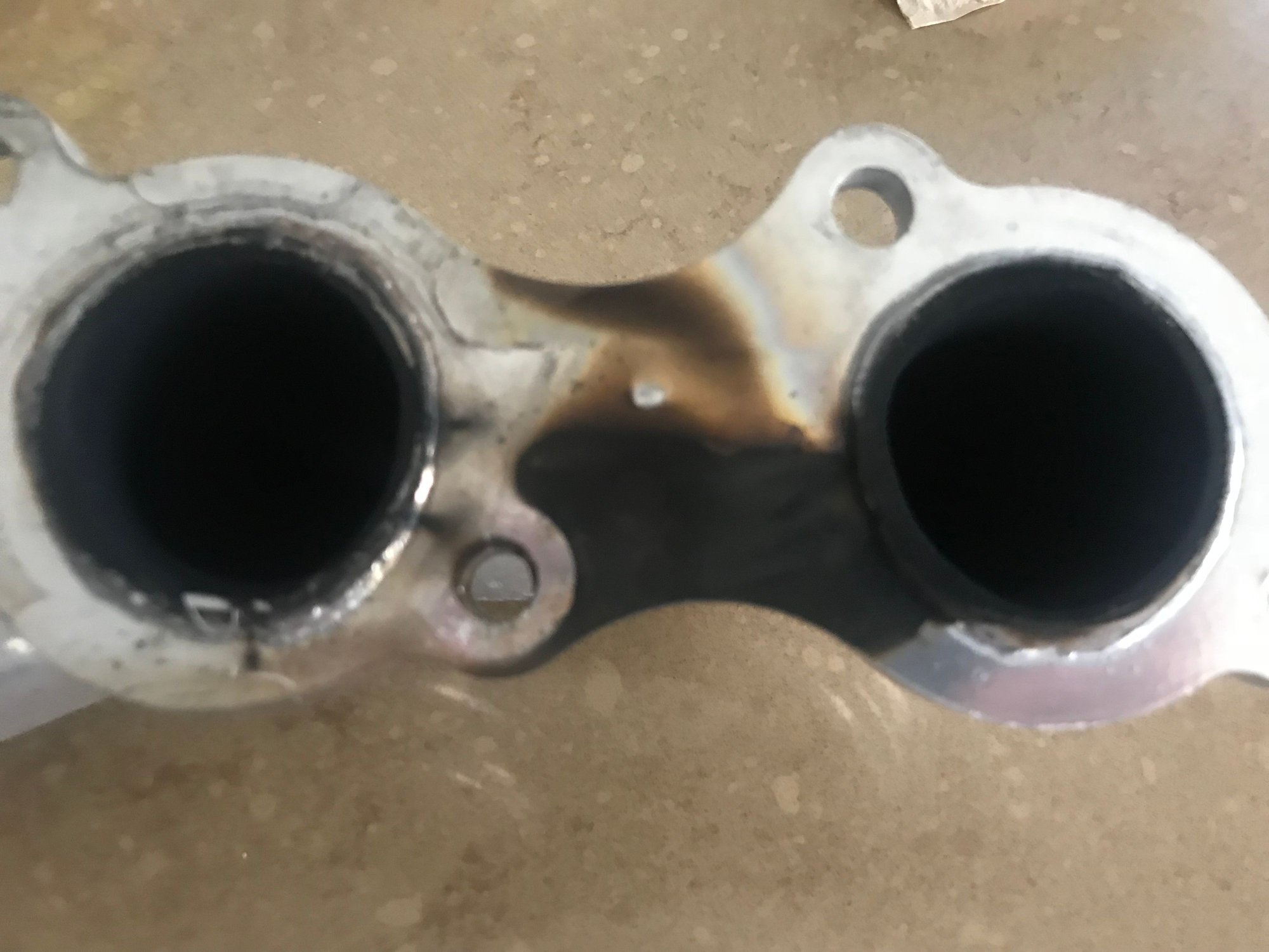

I bought the first gen Sikky headers. Had problems with their aftermarket dipstick, ended up bending the original and it started leaking oil. Went with silicon patch jobs until it started leaking too bad. Also, after install it was evident there was an exhaust leak, most times would seal after it warmed up.. Called Sikky, and asked to purchase another of their aftermarket dipsticks. They said they don't stock them anymore. Asked for the manufacturer's number and they refused to provide it. Trying to be a loyal customer I asked for a discount on the second gen header. Their answer, "No."- Wow... Car ended up sitting for a long time, too bummed to put effort into it. Called RR-Racing, got the PPE hesaders installed and it's badass. Bought many products from RR-Racing, great customer service- good to know there are good people in this field after getting shafted by Sikky- i waited a while to post this as I didn't want to drop F-bombs in the post. If you're looking for headers, I know one place not to go.

I don't know much about headers but shouldn't those be machined across the face after welding? Even with a fixture that steel will bend during welding, bent steel will never seal no matter how tight those bolts are. Just my un-qualified opinion.

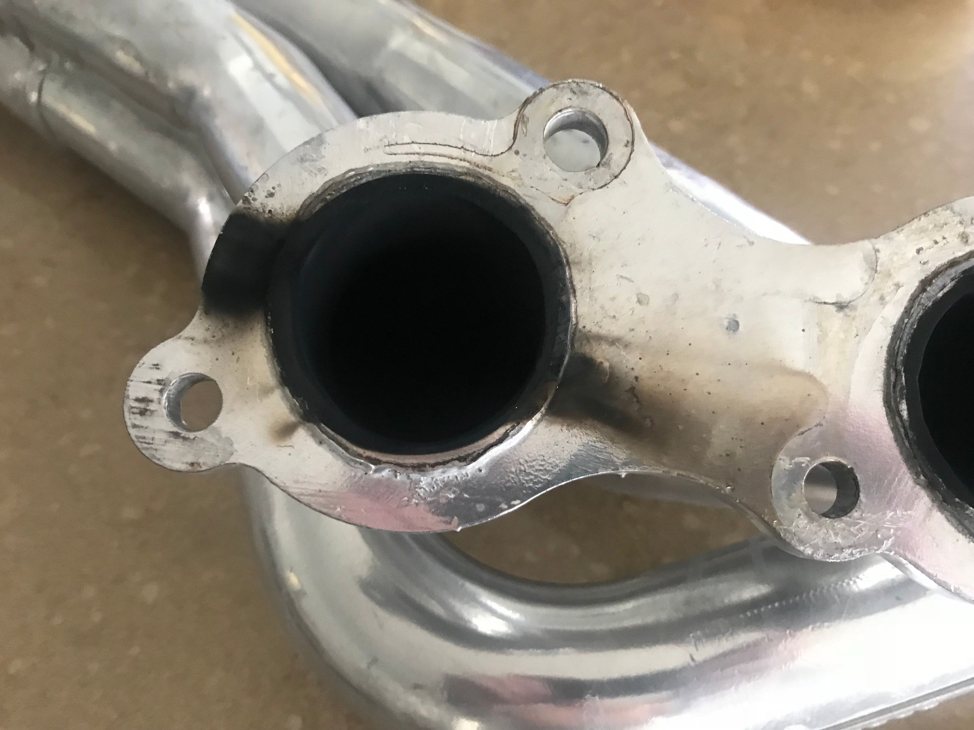

^^^^You mean Like this:
Lou
Exactly!

The mounting surfaces of the used PPEs i just sold were as spotless as flowrider's after 5k mi.

Flanges should've been cleaned (sanded flat) prior to install. Our cars use a MLS exhaust manifold gasket, the surfaces have to be smooth to properly seal.
