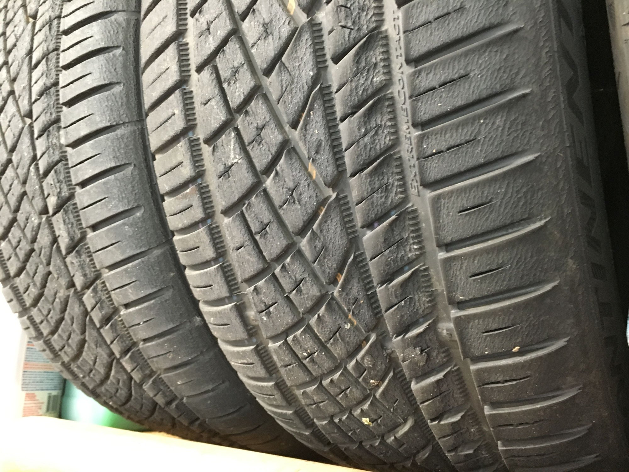

Originally Posted by smaggs
Do the DWS really wear that quickly on the track? I've used those on my previous car and this car just on the street for commuting and some mountain roads and they've been great to keep on all year round. I'm hoping to get on a track in the near future and was just going to use these but will think twice and save up for a second set of wheels/tires if i'm going to shred most of their life in one trackday
If driven hard enough in warm weather (it was low 80s, IIRC), they won't last very long at the track. Here's what the fronts looked like afterward:
However, there are a few other factors that led to those results. I’ve done 25 track days in the ISF, so I was asking a lot from these tires after being used to the RE-71s. Also, that set of DWS was staggered (255/275), as opposed to the 275 square set-up with the RE-71s. So I was really working the fronts hard in the corners & under heavy braking.
I’m not even all that hard on a proper track rated street tire. I could’ve gotten 6 track days out of that full set of RE-71s without the road hazard damage. In fact, I did use the rears for for 6 total track days (2 with new fronts).
I had an old buddy visiting from NH, and we planned his trip around that track day so he could ride along & enjoy it with me.. We had a blast, despite the lack of grip. So, it was totally worth it!!
-Mike

Good to know. I don't anticipate going through tires as quick as you with a first track day but that's enough to convince me to get some dedicated tires rather than eat up my every-day ones.....tires aint cheap. I'll leave them on for some autocross next year though to get me warmed up.
From my previous posts, you can tell that I am not very fond of Continental. I will never ever own another set. BUT, in this instance you are asking the tire to something it was not designed for and was never intended to do. Just because it comes in a size to fit and ISF, doesn't mean it's suitable for one. And then to further abuse it one the track IMHO, this tire is suitable for a Camry, Accord, ES and etc. It's been my experience that 255s in front are ample on an ISF.
