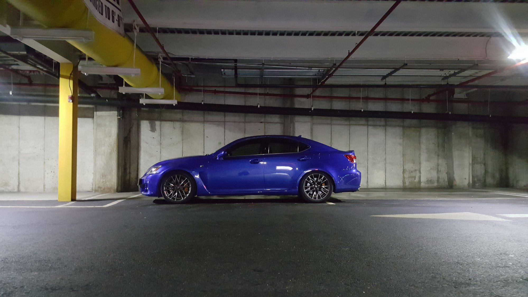

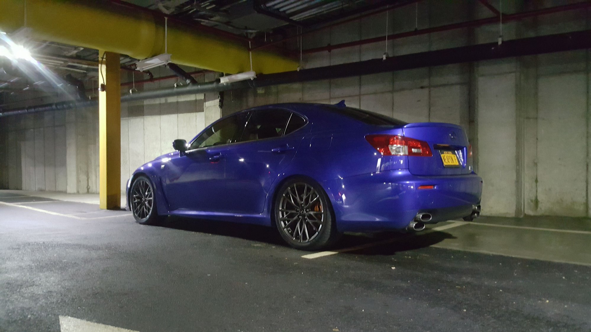

Current setup with old 255/35F 275/35R
Originally Posted by UCrazyKid
If you are replacing all, go for a 245/35F and 285/30R set up this most closely matches factory tire diameters. 275/35 is too tall in the rear. It will look funny and throw of the speedo, slow acceleration.
I know longer run 30 size profile tires on my F due getting bubbles on sidewalls of 2 sets of PSS and 1 set of PS2 on bad roads commuting into NYC. Ive been using 255/35/19F 275/35/19R set for while now. 1st for bit larger side walls no longer getting bubbles and slightly better ride quality. Understeer No longer issue, also for me by going with this setup it puts me close to square setup but still staggered I get benefits of both worlds current front tire 10.04 wide, rear tire 10.83 wide.

Here are pics with General GMax RS tires mounted. Just like Lou pointed out Y rated to 186mph vs W 168mph they have twice traction rating at AA vs A and 75k mile warranty. I like the way they look, first observation comfort is solid 9+ I'm on RRR LCA and Superpro urethane bushing all the way around upper ctr arms, lower ctr arms, trailing arms front and back and WOW have they improved road quality I can only imagine on car with stock suspension system.
Water same 9+, on par with the more expensive counterparts. In first three days I've already driven in two torrential downpours. These tire were extremely stable felt like I was driving on dry roads. When hitting puddles of water in left lane not hint of hydroplaning. My Cousin was driving F first time we hit bad weather and was amazed these were General tires. He was GM for Goodyear.
Will report back on Dry traction after few hundred miles have been logged. So far so good thou.

Thank you very much for the pics and preliminary review.
1. How would you compare the comfort to the other tires you've had in the past (ranking)?
2. What about the noise level?
