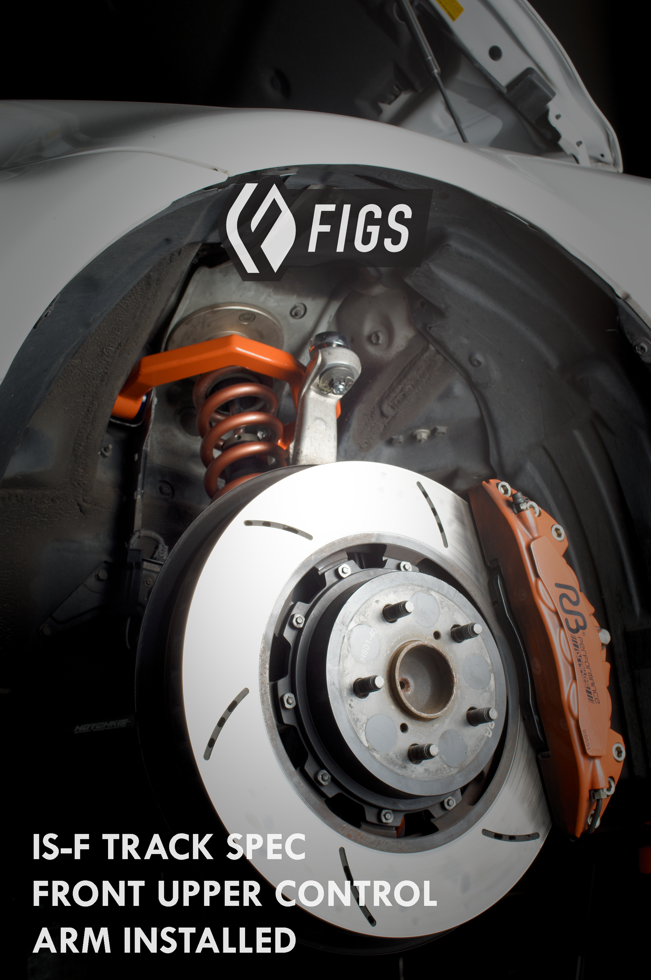

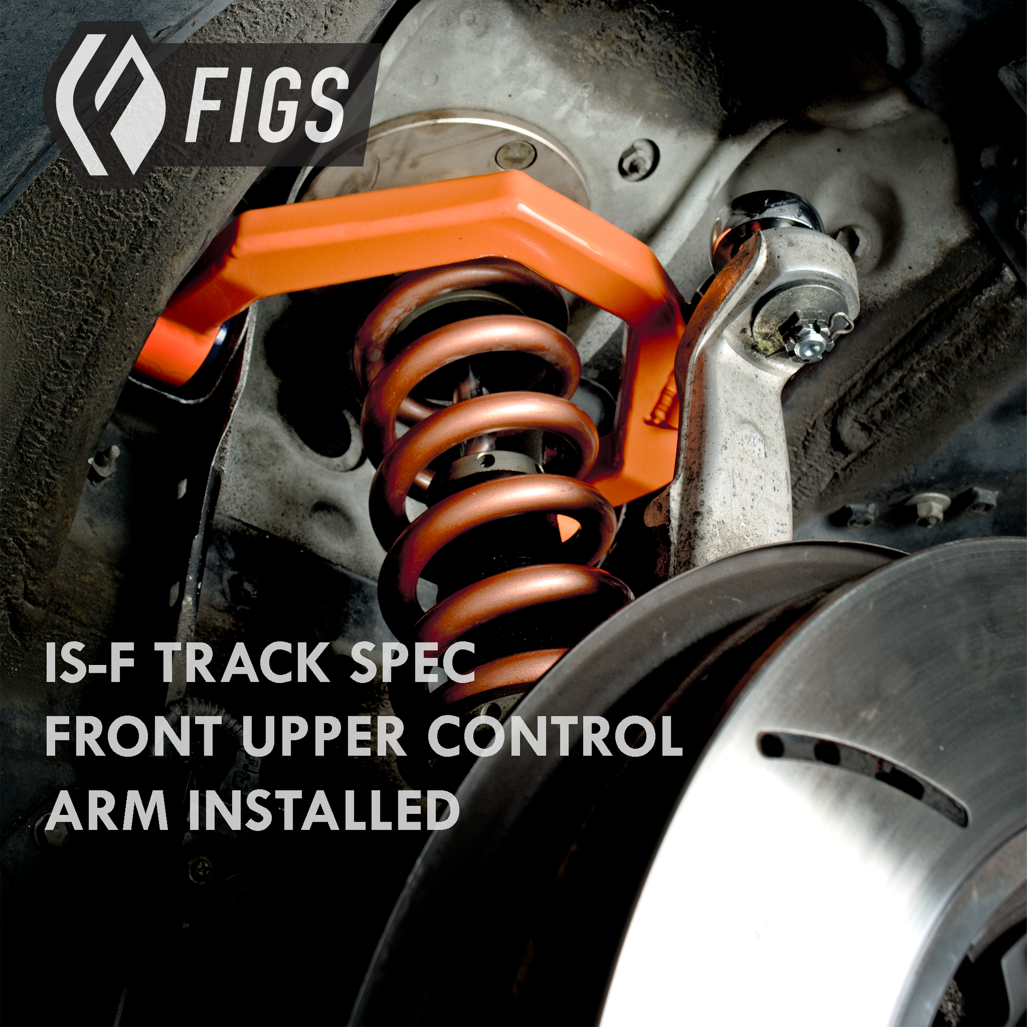

overall camber options

Im on the Figs track spec front uppers, which are fantastic. I run the fronts on most tracks maxed out- which is around -3.7 deg. There are two problems that you'll run into; first problem you will start to run into is the suspension upright will start to contact the coilover spring on droop. I am on Penskes so your mileage may vary based on the spring size your coilover has. Penskes have a 65 or 68mm front spring diameter iirc, other brands can have a larger 70-80mm springs which will cause this interference sooner- like maybe around -2,8 to -3 depending. Second is the castle nut up front will start to get pretty close to the tire. I run a Advan A052 in 295/30 front on a 18x10 +28 and its about as close as i want it to be atm. For the rear I have all the Figs links. Set up after changing all the links and arms is a process but once dialed in you really don't have to mess with it much. For the rear i run -2 to -2.8 depending on track, weather and aero set up for the event.

As much as I'd like to get the figs UCA I don't think the open rod end will have a long service life if being driven on the street as well.
