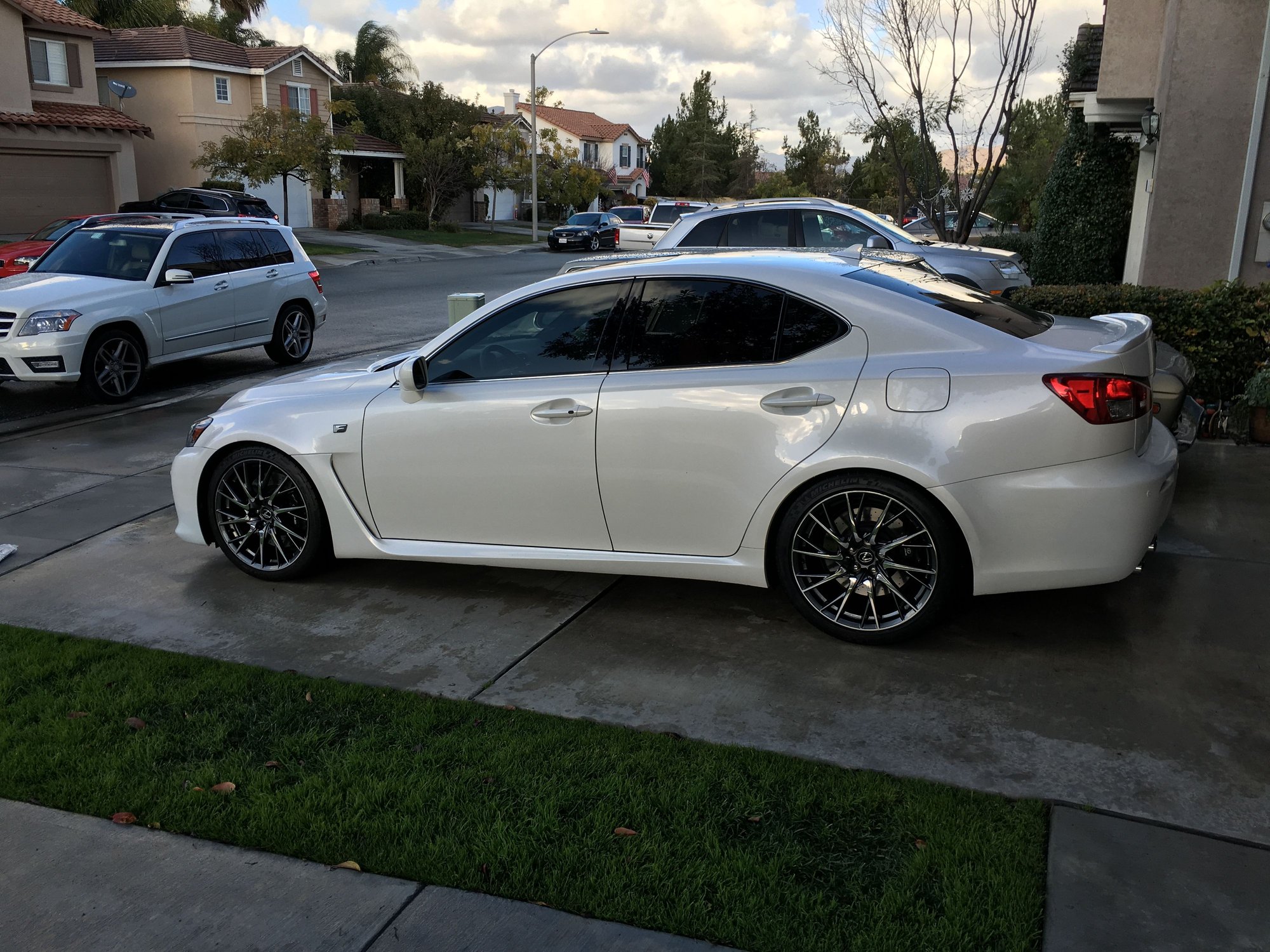

Old Dec 12, 2015 | 10:48 PM
sagaklze's Avatar
sagaklze
Joined: May 2002
Posts: 30
Wanted some 2012s but had no luck...
Went with these instead
Old Dec 12, 2015 | 11:05 PM
BuLLdAwG's Avatar
BuLLdAwG
Joined: May 2003
Posts: 63
From: Nevada
Are those rc350 or rc-f?
Please do give info, I like them alot!
