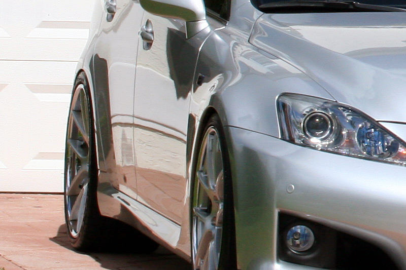

20x11 et52 ADV1
Initially ran them with 305/25/20 Nitto Invo but later changed to 295/25/20 Super Sports. 295 Michelin is actually same width as 305 Nitto and a MUCH better tire (grip, life, etc).
With the 52 offset, it required the rear lips to be shaved/cut/rolled completely.
