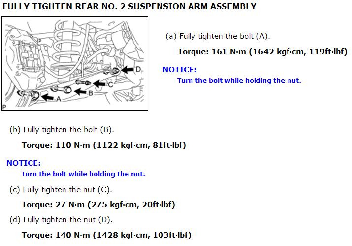

Order a bolt from Lexus. It won't be cheap though. Use a torque wrench this time so it doesn't break again.
