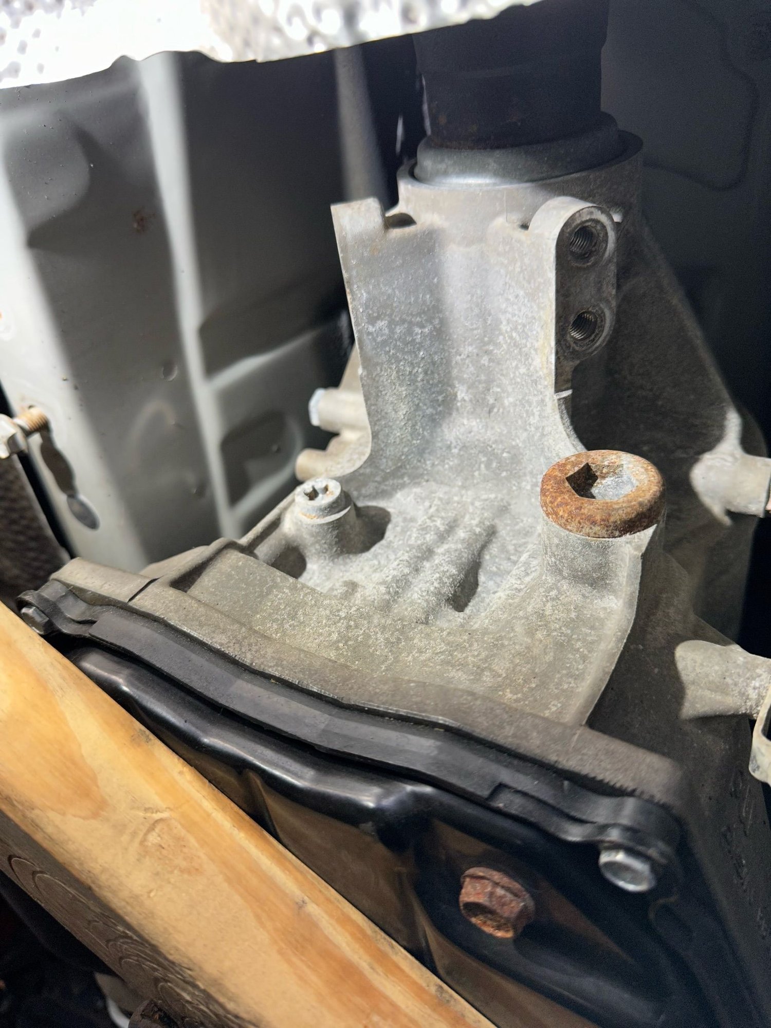

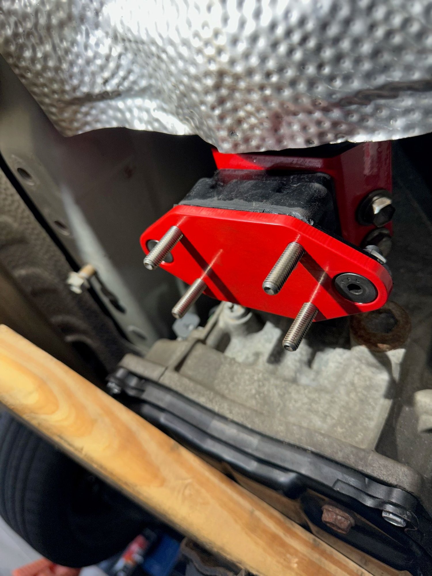

I have had the RRacing Engine Mounts for years and installed the RRacing Road and Track trans mount last month. The shifts in sport mode are noticeably more chrispy and my exhaust seems louder. The car responds to shifts a lot better. Keep in mind NVH is very subjective and both mounts don't bother me one bit. I haven't noticed any transmission whine like the Kein trans mount gives. I heard of other F owners on FB groups complaining about slower gear clunkiness or trans whine. I haven't experienced any of that. My old trans mount was pretty shot so it was a worthy upgrade for me. For the price, it was money well spent.
