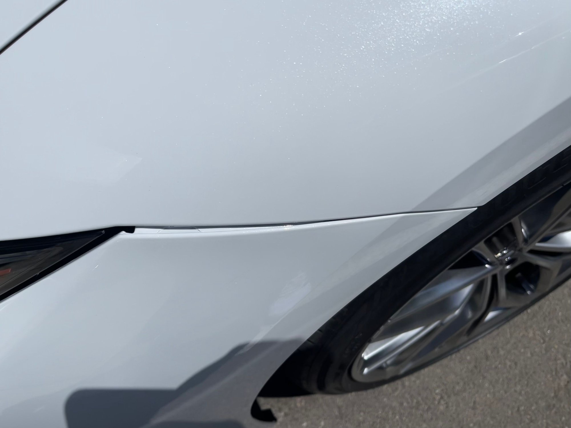

Here is how mine looked while still at the dealership after getting ‘fixed’ … so now on third service visit for this issue. Guessing it couldn’t take its own weight and/or mid 90 degree heat after the bumper was removed & reinstalled earlier today.
what I find wild is, how does the service department hand that back to an owner and call it “fixed”
As we both are in the same boat with our dealership this is what I have done and also believe it might help the other IS500 owners with this issue.
  • Open a case with Lexus corporate so that your case reaches your Lexus regional manager "cases are specific to region".
  • Update the dealer about your open case with Lexus, So that the dealer can create a case file to track the history of the fix done so far for the vehicle and also communicate with Lexus to get the best possible solution.
As you guys know the history of my bumper issue getting fixed at multiple dealerships for multiple times with no permanent resolution. This was the third time they took off the whole bumper to find the cause.
I just picked up my car few hours ago for the third time and this is the latest update that I got from them.
  • As per the body shop manager they checked every possible location to find the cause and also took images to update Lexus on their findings. They couldn't find the specific cause even after multiple tries.
  • At this point Lexus has no available solution for this issue and the corporate left the repair decision to the dealer body shop experts.
  • The respective bumper pins are glued to the bracket that is close to the fender as a temp solution.
  • If the issues arises in future, the best possible solution will be a bumper replacement "having a case history can expedite this process but expect delays with part shortage" or reapply adhesive glue .
I attached a Facebook group response where an IS500 owner is already working on getting the new bumper .
I just drove 25miles @80mph to test the adhesive and so far its holding on good. I will update if I come across the issue again.
I know it requires time and effort to put up with this issue but I personally feel its worth it for this V8 sedan .
Also kudos to the dealership for being proactive to find the cause and fix to make an IS500 owner happy.
