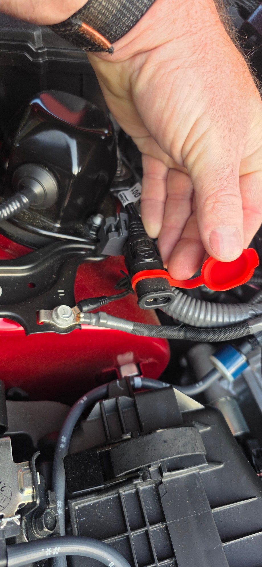

This is the one I use:
https://no.co/genius2
A great product. Search their website if you want one that mounts permanently to the firewall and battery. All you have to do with that one is plug it in. I have to move mine between my IS and Tacoma.
