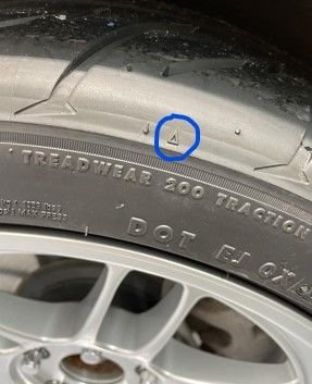

Toe and toe deflection can certainly cause tire wear at the inner or outer tread block.
However what I am looking to correct is outer wear from hard cornering. This is from not having enough camber and the side force on the tire is actually rolling it over onto the shoulder/sidewall transition. Check out the sidewall of a tire and note the triangles with 1 corner pointed toward the tread. These are part of the Tread Wear Indicators. Additionally, general advise for track & AutoX is the triangle should only sees wear to that tip closest to the tread. When cornering more aggressively without enough camber, more of the triangle gets worn away. This is by no means a fact, just a reference point.

You sir are a very smart individual and are looking at the right use case. Far more advanced than most. Also kudos for taking the car to such things and enjoying it.

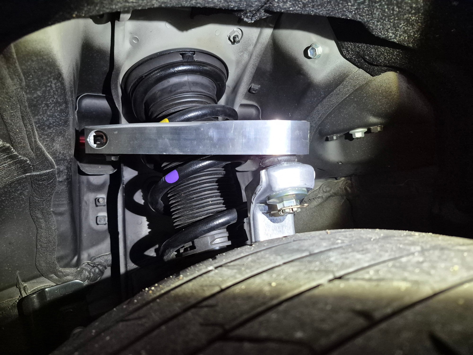

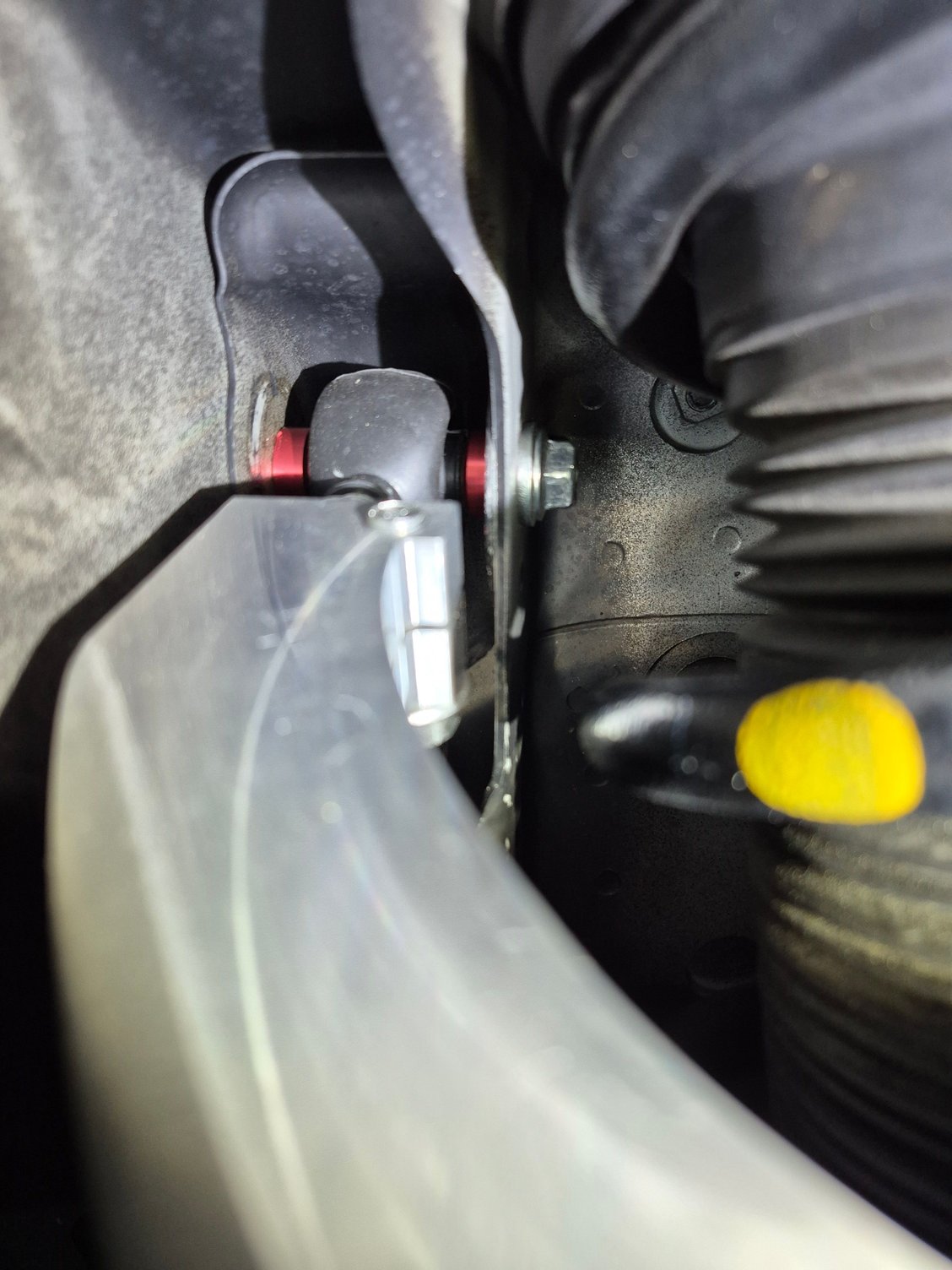

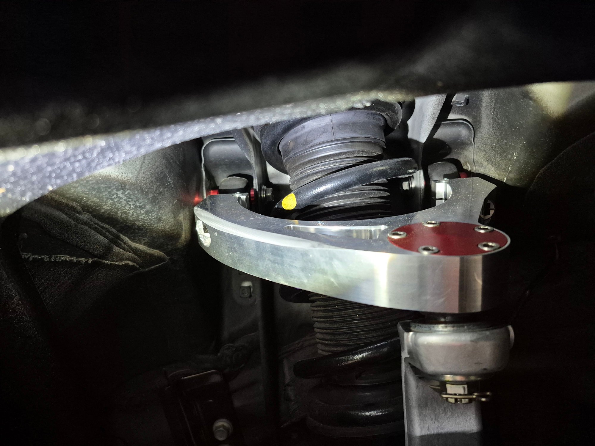

Update - Have the RR Racing UCA's installed and quite happy with them. I haven't noticed any change to NVH (yet at least) and have driven on a mix of smooth, bumpy, and broken pavement. I did add some heim joint boots to protect the spherical surfaces from debris, muck, and water.
