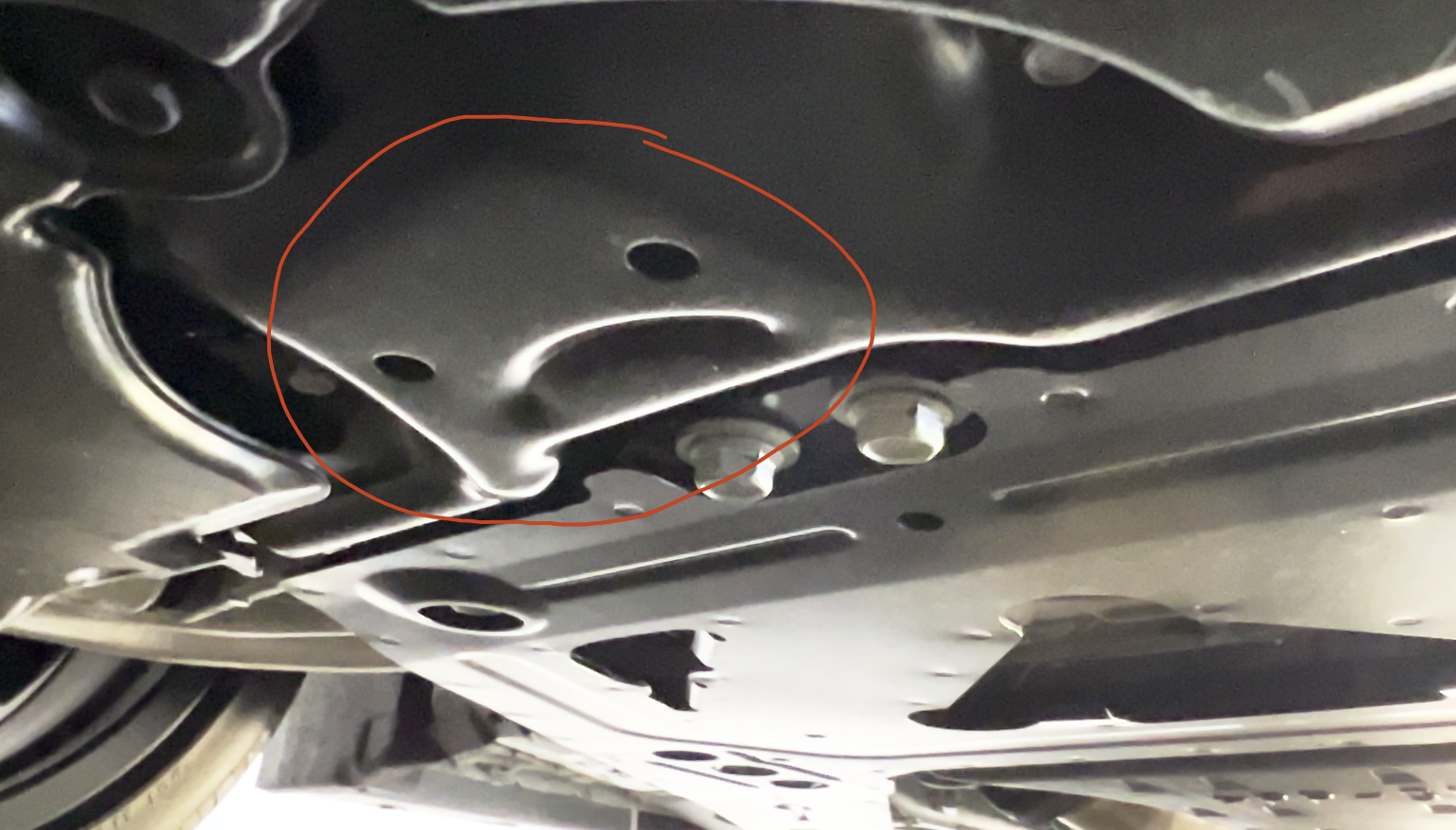

Question
Is the circled area the front jack point on the 2024 MY? I can't really get under the car that well to look around more and this looks like it but need confirmation. Thanks in advance.
yep that’s it…I’d just advise putting a jack pad or run to the sporting goods store and putting a hockey puck on the jack saddle.
The better HF jacks usually have a piece of rubber on there but it’s not that thick. I have a hockey puck on mine, it prevents metal to metal contact and makes it easier to be precise with your placement so you don’t accidentally bend something.

Thanks for the confirmation!
I purchased a 4 pack of rubber jack pads beforehand and used the one with the slit it in but are they supposed to deform? Once I lowered the car the pad's shape went back to normal but didn't have time to try again. That and I wasn't sure I should be using the 6 ton jack stands I got since ~15" minimum height looks kind of high now so going to grab a 3 ton set tomorrow.
