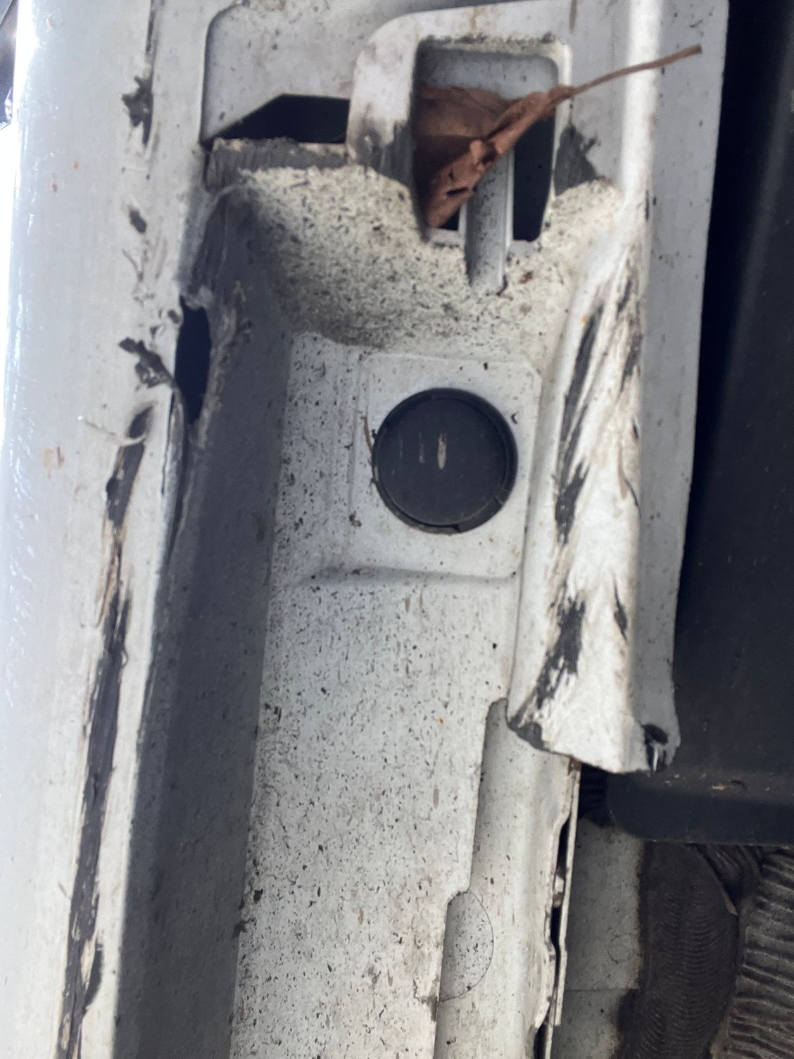

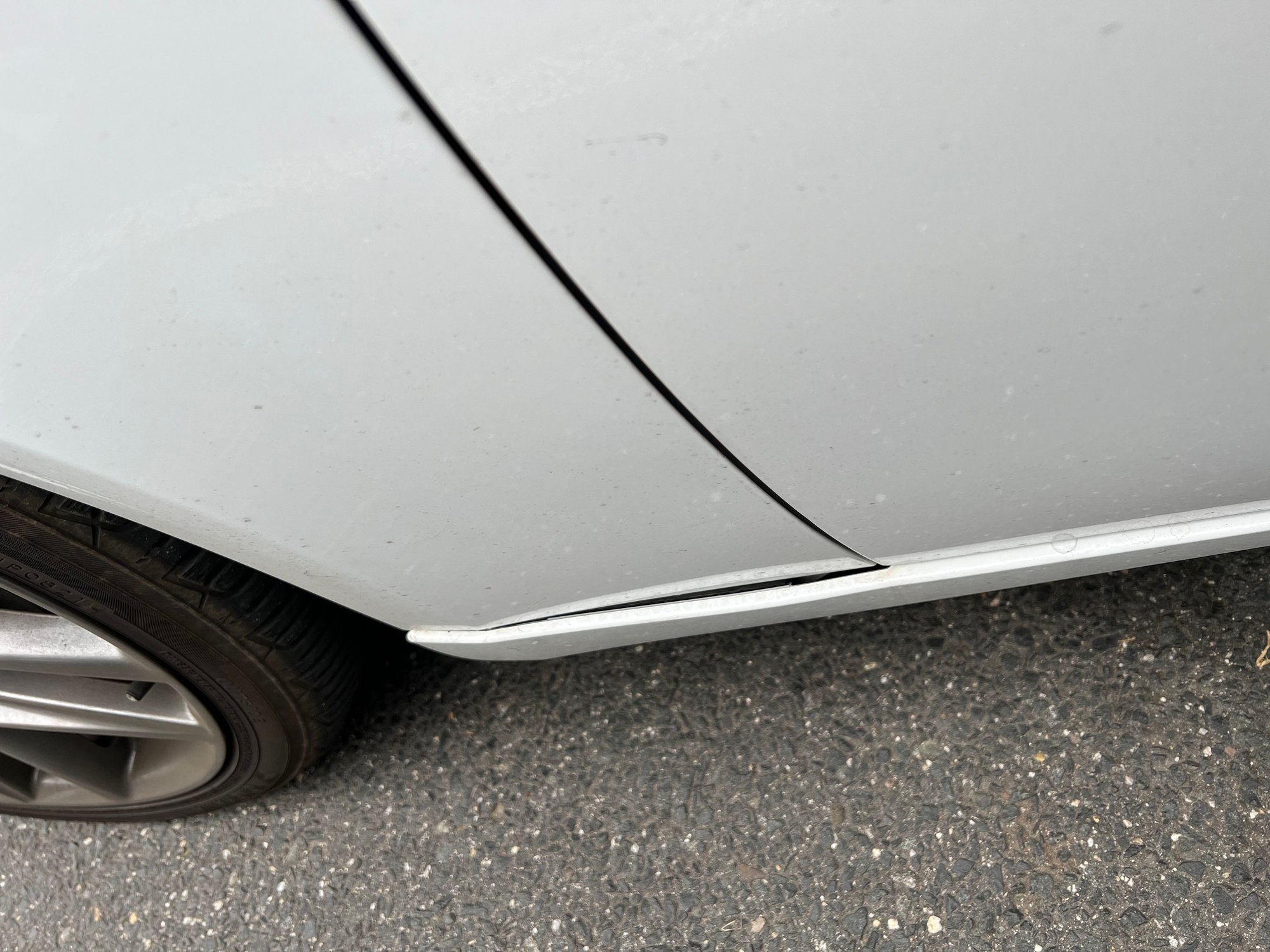

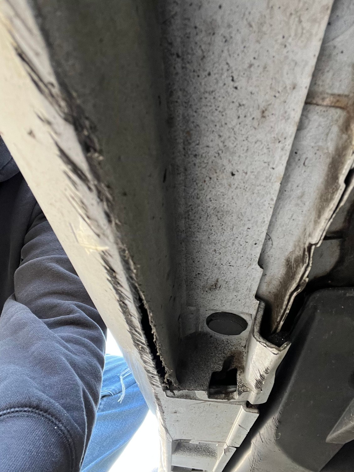

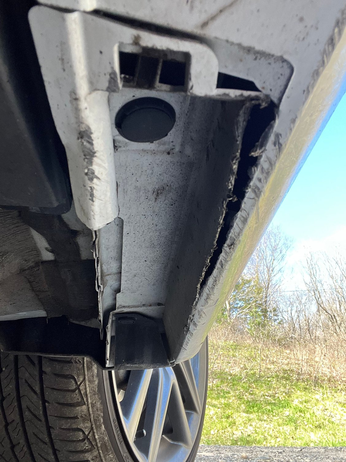

Hey everyone, so long story short I went off a curb super high off the ground and didn’t realize that the car was stuck on an angle with the side rocker panels scraping the floor (it was on such a bad angle that my axle back pipes even got scratched a bit). I had to gas the car a bit to get off this ledge which is probably why the right side is ripped open.
In all honesty the damage isn’t noticeable unless you are looking underneath the car. The only reason I even realized the damage underneath was because I saw that my left rocker panel wasn’t flush and bending outwards.
Would this be worth going to a body shop to fix or replace? Any estimates on how much it would cost and lastly, would you go and fix it?
Thank you guys in advance for the support and advice!
The side rocker panel on the left driver side is slightly bent outwards.
Underneath side rocker panel on right side of the car.
Right side rocker panel
Underneath left side rocker panel
Left side
Left side

Probably nobody but you will notice it unless they're buying it from you. So if I were going to keep it for, say ten years, then I would drive it for a few more years, then have it repaired when I got a new paint job.

New side skirt maybe $200-300ish (try to find a totaled one), paint $300-500 depending where, and then install itself would be another cost. Try to push it back in and use some duct tape on the under side where it's ripped and have it attempt to sit flush

the side skirts are held on by 2 Philip head screws and the rest are clips, try pushing it and see if the clips relock

Do you mean pushing the left side thats bent outwards? If so, I tried this already and it won't go back in place, pretty sure the skirt itself is bent.

That side skirt is plastic, correct? I would remove the side skirt, get some high strength plastic epoxy, clamp things together to reshape the damaged area, do some touch-up painting below, and see if that works.

at the very least fix up the paint so metal sections are not exposed to the elements and rust.

He's saying paint any exposed bare metal. Hard to tell from the pics but it seems the only damage is to plastics.
