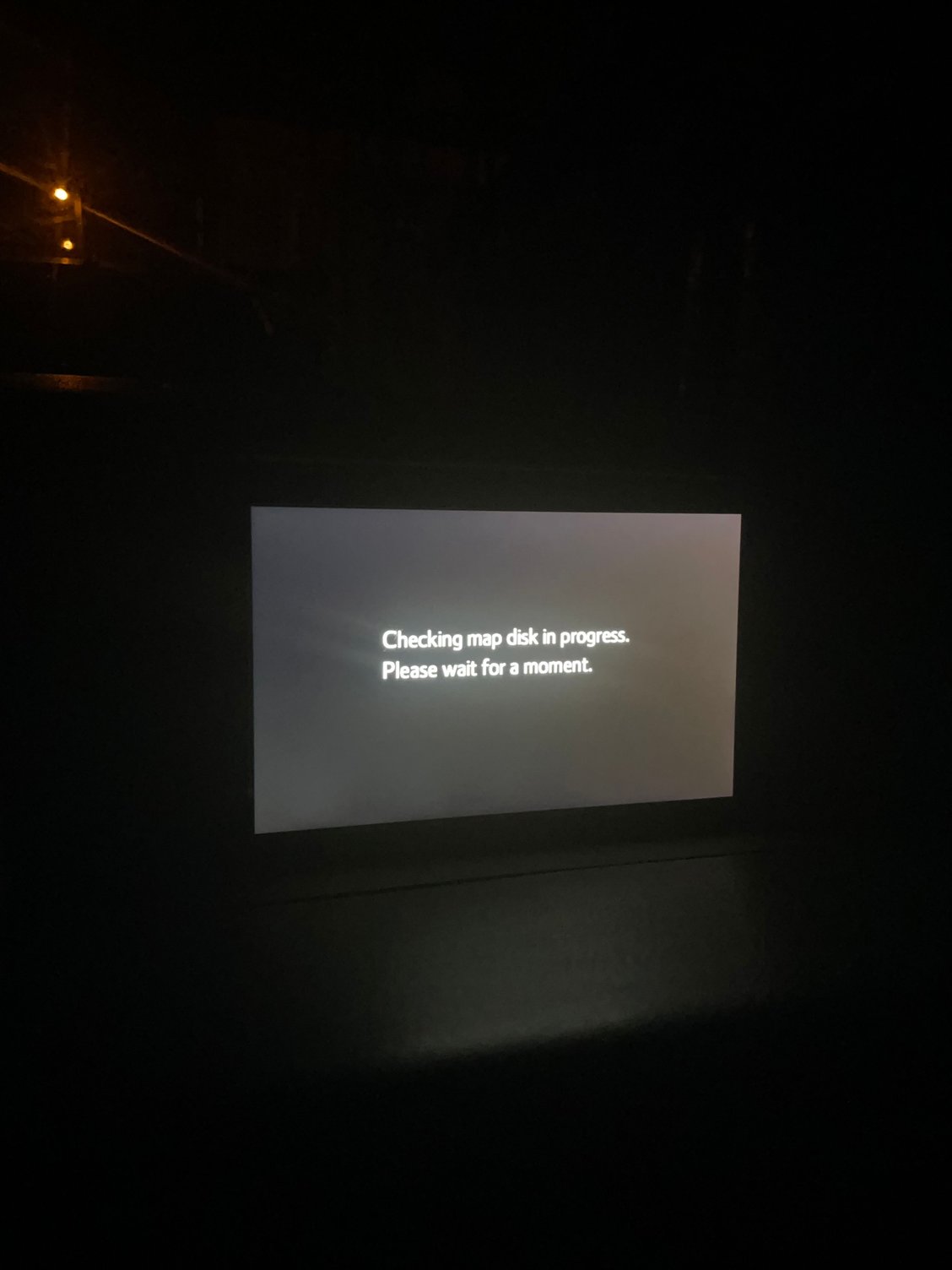

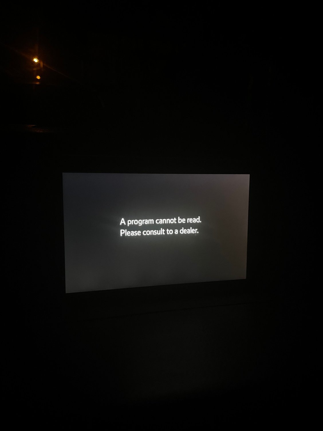

Hi there,
I have issue with 2015 Lexus IS250 multimedia. it's failed after firmware update. In details, when firmware update finished and screen has been written "turn off engine and then turn it on to finish update", I turned it of and turned engine on but after that multimedia isn't turning on. Firstly it says "Checking Map disk is in progress" after few restart with same message it says "A program can not be read. Please consult a dealer" and it doesn't turns on.

I have tried disconnecting battery as you described and after that it continuously restarting with message "Checking Map disk is in progress" no another messages appear. its restarting restarting restarting and showing only this message...

Doesn't write any messages, even not booting not loading. When I start engine shows black screen with message "Checking map disk please wait a moment" doesn't matter micro SD card is in car or its removed.
I have removed radio fuse from driver side fuse box, after 20 minute placed back but doesn't matter. Starting with message Checking map disk and after few restart with this message it says A program can't be read...
How can I solve if it is boot loop? I think firmware update doesn't finished and at this moment there is no firmware installed. because during update process when it says "park vehicle in safe place, turn off engine and turn it on again" When I turned off engine and turn it on the update didn't continued started same message I have now. (Checking map disk is in progress)
