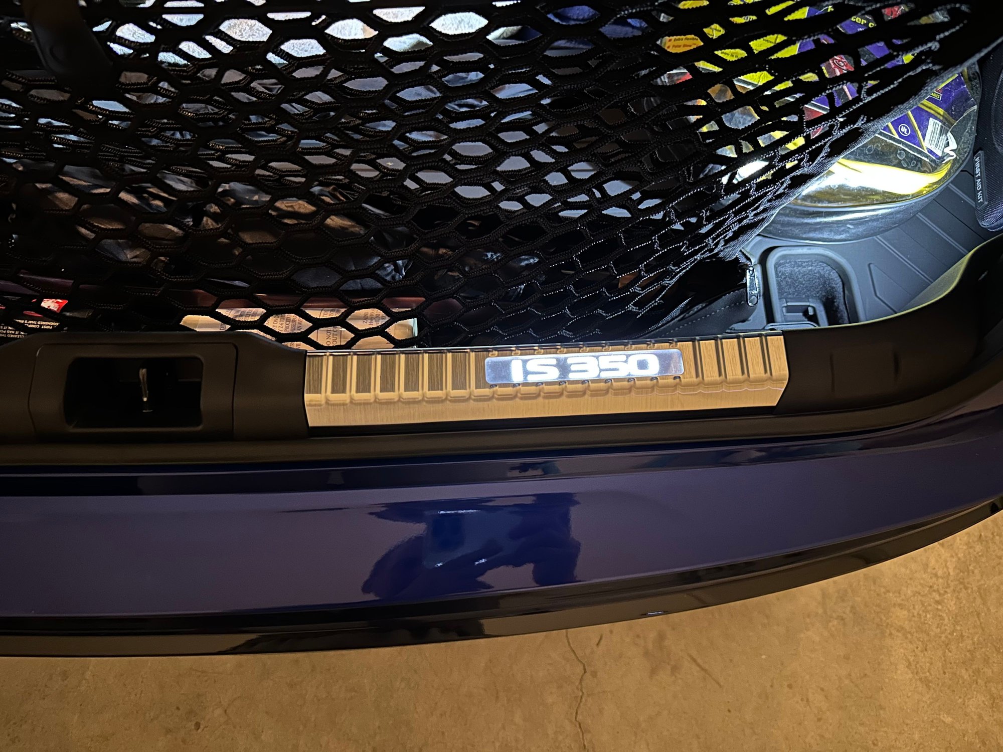

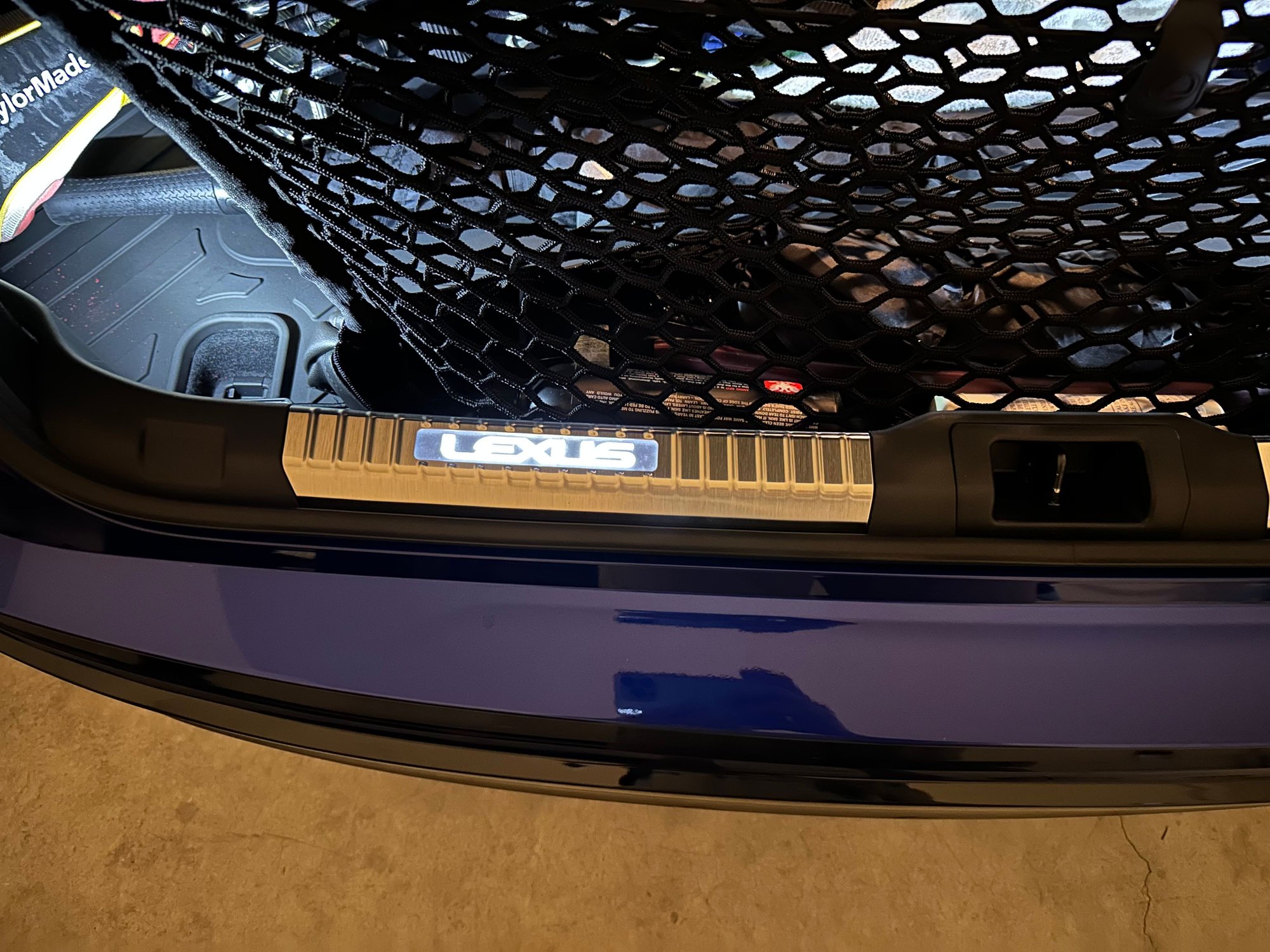

Just installed the Illuminated Trunk Sill on my 2021 IS350. It shows "IS350" on the right side so maybe they'll come out with a IS300 and IS500 version in good time. Besides having illuminated "LEXUS" and "IS350", it comes with x2 corner white LED spotlights which does a great job of illuminating the trunk. Install was fairly easy, 3/10 difficulty scale.
Part Number PT9445321002. I bought it for $230 from Bell Lexus.
