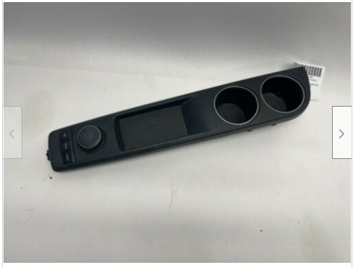

Was wondering if my 2014 lexus is350 f sport with ML & navigation would be able to accept the dial controller instead of the jog. I am attaching photos for reference. I currently use the top one and was wondering if the bottom photo could be used in my current cars setup.I prefer the dial over the jog controller and I like that it has a spot for a phone so thats why I am interested in this.

I was able to swap the consoles in my 2014 IS250. My armrest looked like your stock one. The only problem is that I was not able to use the back button.

To clarify for the original poster though, @TophersGRG , I am unsure if joystick to wheel dial swap is a direct plug and play and would work. I'm heavily leaning towards it not working as I would think your navigation system is designed to recognize only that style of input, I doubt it would recognize a wheel control vs a joystick as they respond to those two different styles of input differently on the screen.
Another reason that leads me to believe that the input style swap would not work is because if you look at the aftermarket android headunits that are for sale, you have to select which input style you have, which comes with a different connector harness depending on which you have. If they were directly swappable, I would think it wouldn't matter and the harness plug would be the same, but they are not.
I believe that TxasLexus did a joystick to newer model joystick swap, same input style, just newer, not a different input method swap like you are asking about.
