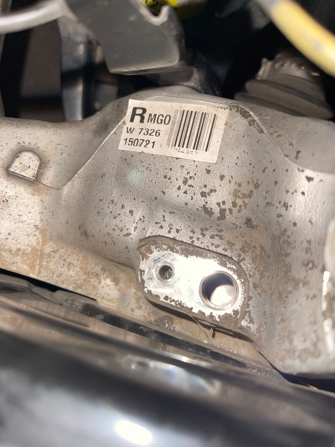

It doesn’t have an O-ring. It almost appears like it’s too long… although obviously it’s not.
The sensor
How far the sensor goes into its space
The space the sensor goes in
Old Aug 1, 2021 | 09:16 PM
Sasnuke's Avatar
Sasnuke
Joined: Feb 2017
Posts: 6,260
Likes: 1,752
The sensor
Does it feel like its hitting something, or just not going into the hole far enough?
Given the sensor came out of that hole it has to go back...maybe corrosion is making the hole tight?

The hole is free of corrosion and debris. I don’t know what’s making it not go in. It feels like it’s hitting something
Old Aug 2, 2021 | 08:26 AM
Deklan's Avatar
Deklan
Joined: Jul 2021
Posts: 25
From: Sd
I figured it out. When I put the bracket that slips over the axle back into the hub, I didn’t have the slot that was cut out for the sensor lined up. I backed the axle off just enough and go it to move and it fits in now.
