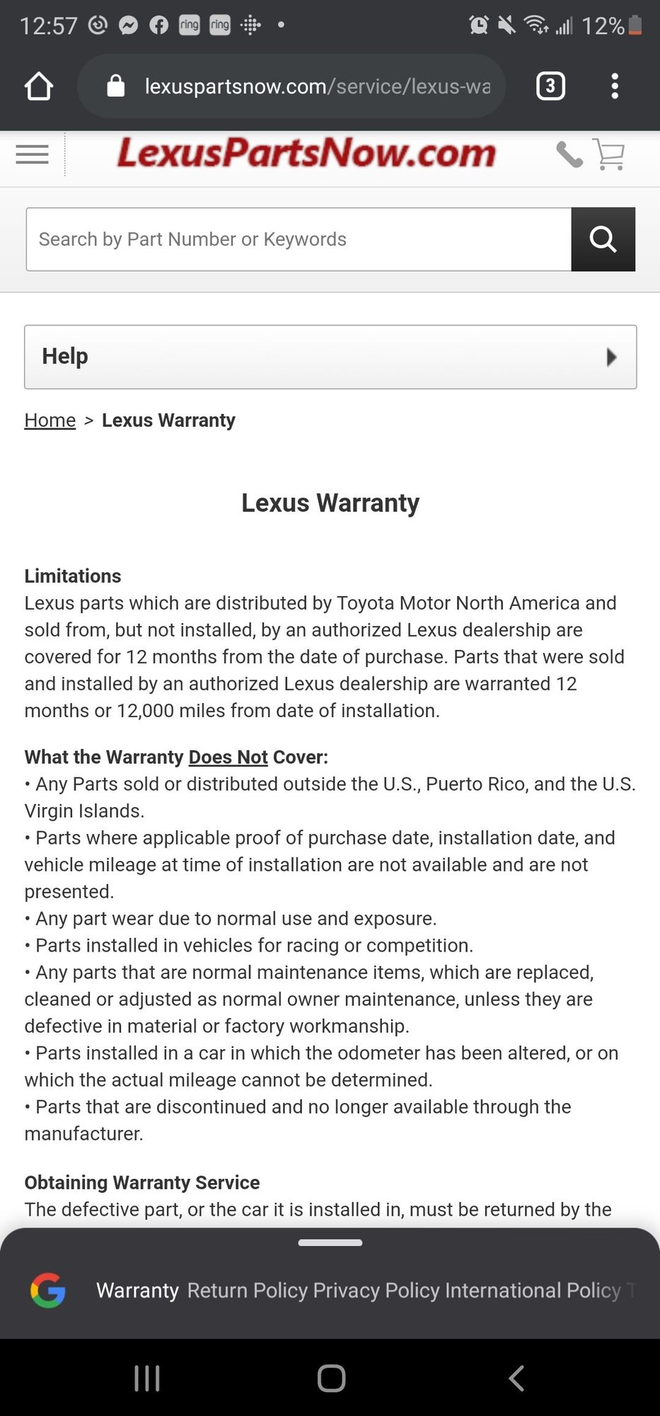

First and foremost "Thank you" for every single suggestion you all have made. I decided to order OEM from https://www.lexuspartsnow.com/
Cost 104.00 each with it's Lexus warranty. Total with shipping 217.00. It will take a few days to receive.
