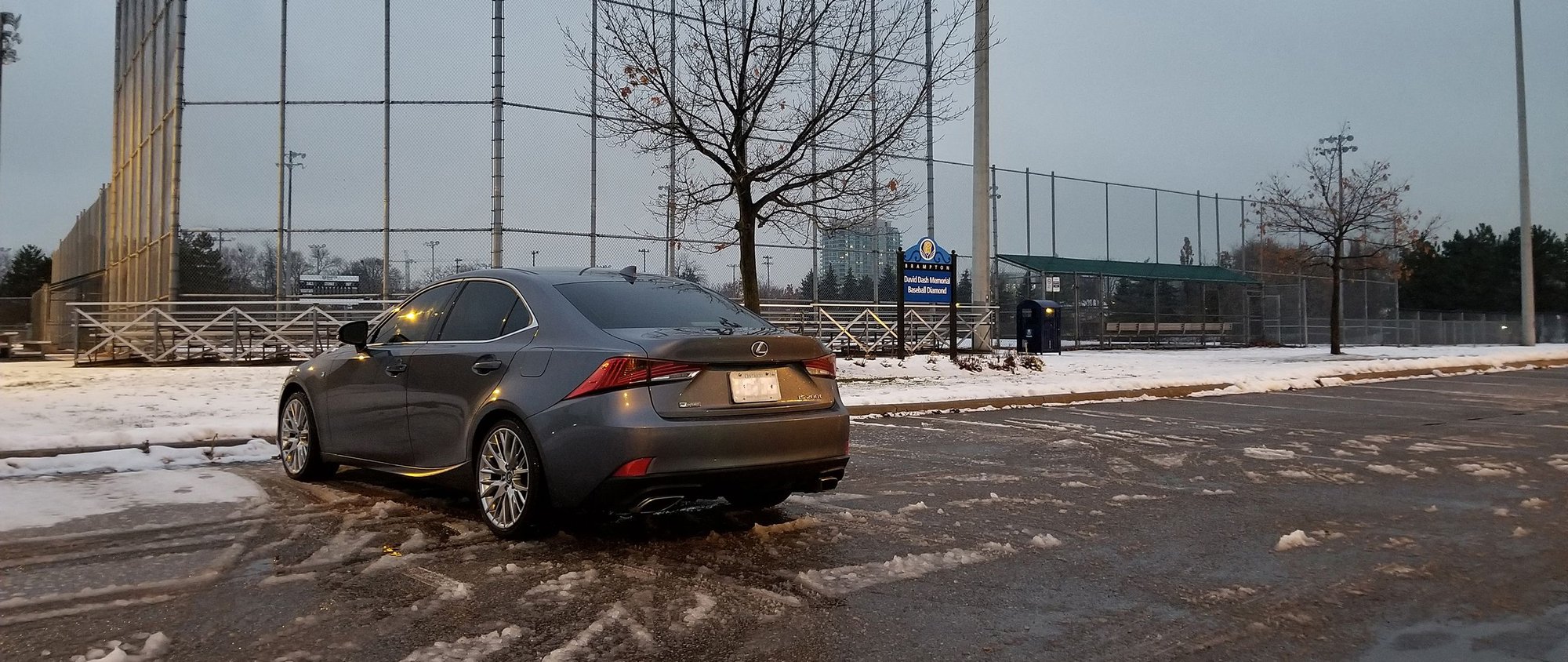

Bit more oversteer, but not enough to be that noticeable during normal driving.
My winter wheel and tire combo seem to be lighter than stock, so the car during dry weather seems to have a bit more get up and go.
